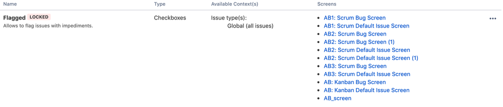

@Laryssa_Carvalho , @John Funk - how did you guys manage to add additional options/value to the field 'flagged' to begin with?
For me, as an admin on JIRA Cloud, its 'LOCKED' inside Settings > Issues > Custom Fields.  Thanks!

Hi @Anuj B - it was not locked beforehand when I was able to add them.  :-(

Not sure if there was an update on the question from @Anuj B but it seems for cloud users the Flagged feature is locked. Which is fine if other values were baked in.
