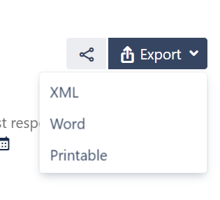

I am using the Export drop-down menu and selecting Word :)
Fran Garcia
October 17, 2019
That export shows the fields that have a value in that issue and are defined in the screen (i guess the view one) defined for that issuetype in that project
Here there is some (poor) explanation about how to change the template of export.
https://confluence.atlassian.com/jirakb/customise-word-export-template-for-jira-applications-296094716.html
