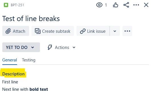

For all the v2 endpoints for any Jira platform type, the content of Description field is plain text with optional Wiki markup. Put markup formatted plain text into your JSON description object, and that's what will be rendered in the Description field.:
"project": {"key": "BPT"},
"issuetype": {"name": "Story"},
"summary": "Test of line breaks",
"description": "First line\nNext line with *bold text*"
Will result in the issue:
