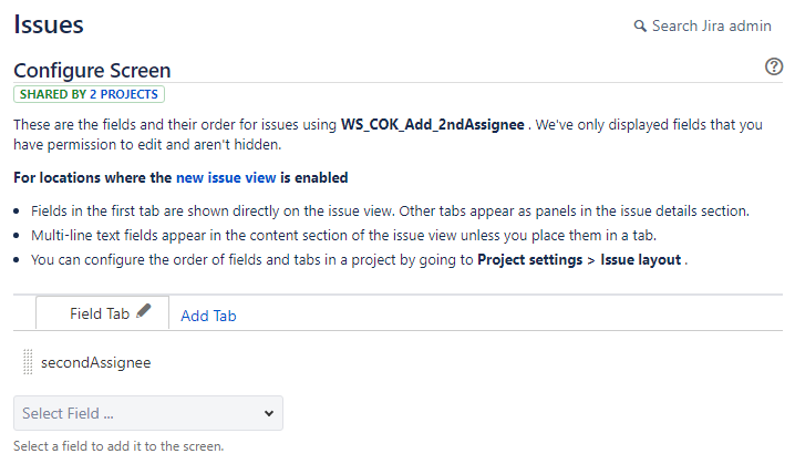

I suspect two things you may have possibly missed,
  • Adding the custom field to the screen (since you only see the comment area)
    • Go to issues -> Screens : In the search box, type te name of the screen you have created and click on it, then as shown below, in the "Select field..." drop down list,chose the customfield you want to show
  • As @Gökçe Gürsel {Appfire} has mentionned, check the field configuration, it's possible your field is marked as "Hidden"
    • Go to issues -> field configurations, click on the field configuration corresponding to your project then search for your field, if you see the option "Show", then your field is hidden and you should click on Show to make it visible

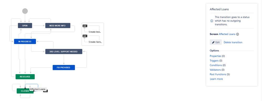

Stefan Zabunov
September 6, 2021
Hi @Gökçe Gürsel {Appfire} and thanks for your reply!
I apologize, I am not sure which part of the transition precisely you want me to share. Text, the diagram?.. I hope the attachment would be enough.2021-09-06_13-19-47.png
I have to admit that I tried to reproduce this based on a similar button we do have, but that one is used to update an existing value.
As for the custom field, I just added a new and selected "Number field" as this should be the expected format. I created a screen where I only have this custom field and later assigned the screen to the transition.
Thank you for your time!
