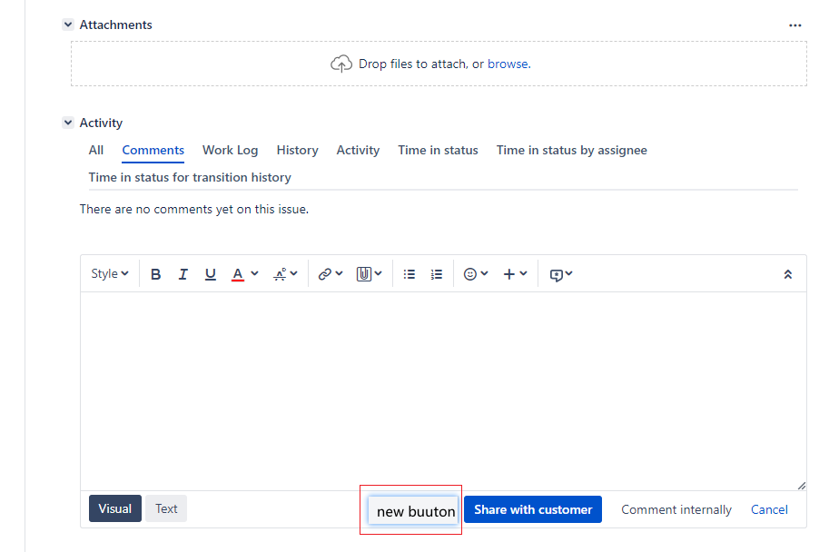

Hi people:
Is it possible to create or add custom button on on the Comments at input box bottom
we want to add new status after user creat new comments,so need a new button
When button is clicked The ticket will change status to 'Pending' status
such as
3 answers

Hi @Dave Mathijs  ,the button for user change status immediately,without having to slide to the top of the page.
about script devlop,can you show me more info.

We have realized that auto-transitioning to "waiting on customer" is not ideal. Sometimes we want to update the customer of what we're doing without having that transition. Other times, we do want the transition to occur, so it would be nice to have a button that's just for commenting, and a button that is "comment+transition".
