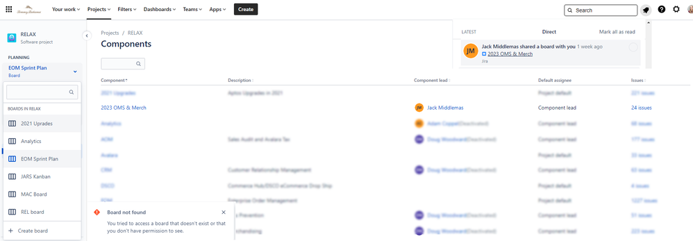

I created a Scrum Board in Jira and we changed the name of the board and the Component linked to the board, but now I can't access the board. My manager, who I handed the board off to after it was created, can still access the board and tried sharing it with me, but when I click on the link I get the Board Not Found error.
I have tried clearing my cache, accessing from share link, and accessing by searching for board, but I am unable to see or access the board. I am assigned tickets on the board and I can get to the tickets by using an assigned to be filter, but I'd really like to be able to access the board.
2 accepted

I created the board to a Project (RELAX in the screenshot). When I handed off, we just changed the admin.
When it was originally created we were using a different component, I don't have access to create components, so my manager created the new component and switched the component in the board settings. At that point I was still in the Board settings too, but at some point during us making the changes, I stopped being able to see the board. I was still the admin of the board when the issue started. My managed changed himself to be the admin and tried to share the board with me, but I still can't get to it.
It really feels like the board became corrupted somehow
