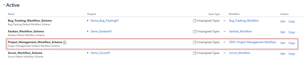

As shown in the figure, I want to delete the workflow scheme that is not in use, but the workflow scheme state is shown as active, which should be inactive in theory.
Now what should I do to delete this workflow scheme.

I have tried to use this workflow in other projects, but after stopping using this workflow again, it is still active.
Hi Yong,
That is very strange. Maybe try to attach it to a Test project, then replace it on the Test project with another scheme to see if that frees it up.
