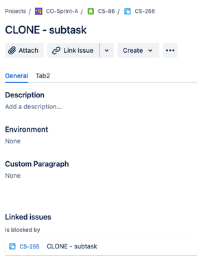

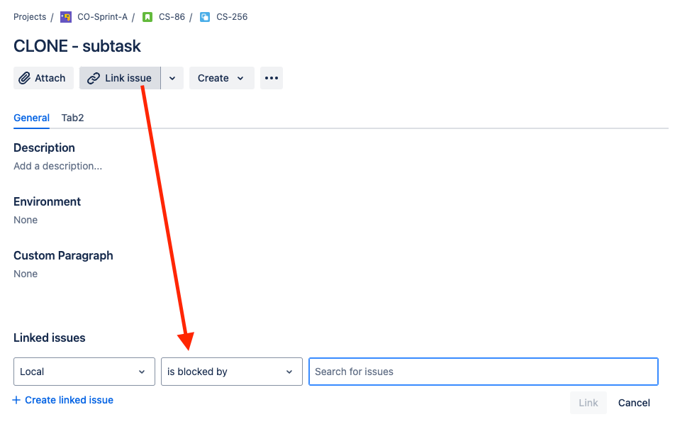

If I open CS-256 and click on the Link Issue button, that opens a Linked Issues entry row. (Ignore the field that says "Local".)

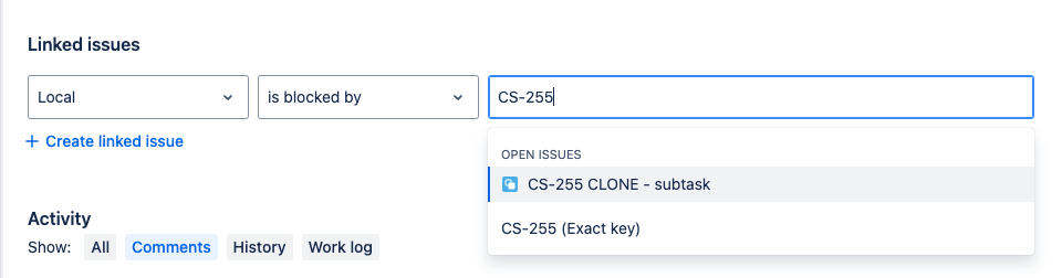

In the field the arrow is pointing at, I select "is blocked by", and in the field to the right of that I enter the issue key CS-255. This will indicate that CS-256 can't be worked on until CS-255 is finished.

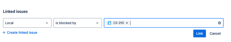

Select the issue to fill in the field.
Click the Link button to save the link. The result looks like this:

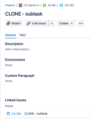

And if we look at CS-255 we see this:
A "directional" link is one that clearly indicates which issue precedes the other. The specific link types you can choose from depend on your system configuration. You'll want to choose a link type that you use in the subtask set only to indicate the order in which they should be done. Don't use that same link type for anything else within a set of subtasks.

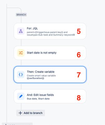

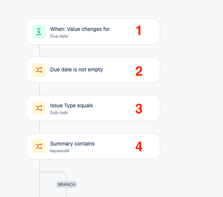

The rule for updating issues based on a change of Due Date would be:
1. Trigger on a change to Due date
2. Confirm Due date is not empty
3. Confirm the changed issue is a sub-task
4. Check that the Summary of the changed issue contains keywordA

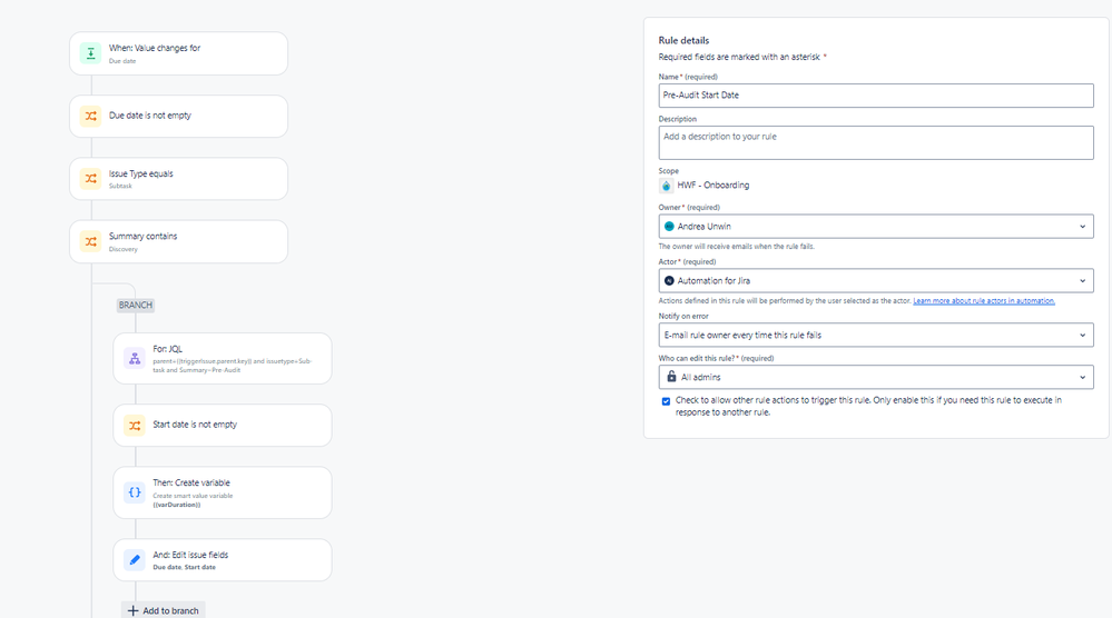

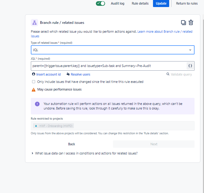

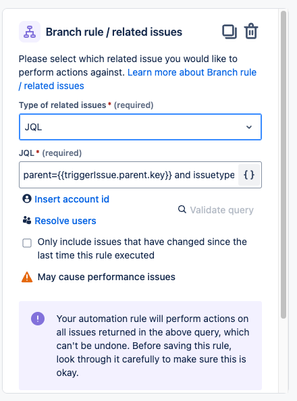

5. Branch to related issues based on a JQL statement to get the sub-task under the same parent as the trigger issue, where that sub-task Summary contains keywordB.
6. Make sure the related issue has a Start date value.

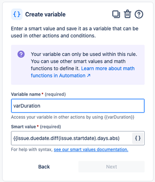

7. Create a variable to calculate the duration between Start and Due for this related issue.

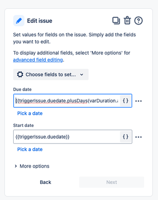

8. Edit the related issue to set the Start to the trigger issue's Due date, and set the Due date to the trigger Issue's Due date plus the original duration of this related task.
Details of 5, 7, and 8:
JQL: parent={{triggerIssue.parent.key}} and issuetype=Sub-task and Summary~keywordB
Due date: {{triggerIssue.duedate.plusDays(varDuration.asNumber)}}

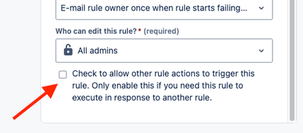

On the Rule Details page you would have to check this box:Screenshot 2024-08-19 at 9.26.53 PM.png

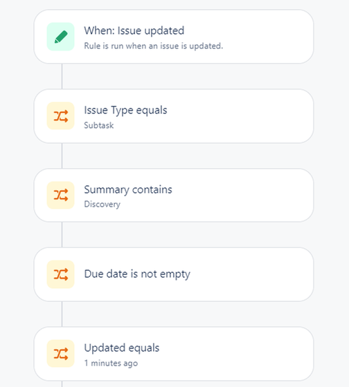

Andrea Unwin
August 28, 2024

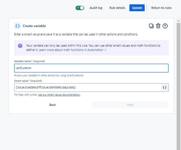

This looks great - i think it is nearly complete. I tried this and it didn't quite work... but I think it has something to do with the sytax in step 7 smart value: {{issue.duedate.diff(issue.startdate).days.abs)
is it supposed to be: {{issue.duedate.diff(issue.startdate).days.abs}} ?
Andrea Unwin
August 28, 2024
I changed the code to: {{issue.duedate.diff(issue.startdate).days.abs}}
but it is still not showing a change to the start date of B when I edit the start date of A.
Trudy P Claspill
August 28, 2024
Yes, indeed! You caught a typo I made!

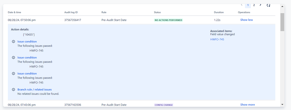

1. Screen images showing your entire rule and the details of each step.
2. Screen images showing the actual names of the relevant fields in an issue.
3. The output in the rule execution audit log.

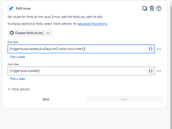

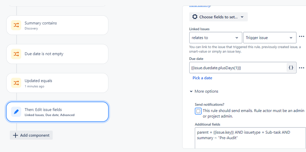

Andrea Unwin
August 28, 2024
Screenshot (189).pngScreenshot (186).pngScreenshot (187).pngScreenshot (188).pngScreenshot (190).png
Andrea Unwin
August 28, 2024
In regards to the "The rule will have to be adjusted to use the fields you're actually using for the starting and ending dates in your issues in the Conditions and in the smart values. Note that field names in smart values are case and spacing sensitive, and if you have multiple fields in your Jira instance that have identical names they you will have to find the field ID for the fields and use that instead."
I changed the field for KeywordB to "Pre-Audit" and I changed keywordA to "Discovery" so I think I covered those bases. I am not supposed to change the Syntax of "triggerIssue" right? Dont change that to a specific field name?

and in step 5, the "For:JQL" do I keep the box for "Only include issues that have changed since last time this rule exectued" unchecked?
Trudy P Claspill
August 28, 2024
If your field names have spaces in them then they should have spaces in them in the smart values.
I will note that Due date is a special case. The system field named "Due date" can also be referenced using "duedate".
Yes. Let's go through why.
Let us say that box is checked and the rule has never executed.
Let us say that you have two issues (X-1 and X-2) that have this series of subtasks.
Let us say that the last time the subtasks keywordB was updated in any way for either of these issues was on Monday.
On Tuesday you update the Due date of subtask with keywordA under X-1. That causes the rule to run, and run the JQL to find subtask keywordB under X-1 and update its Start date.
On Wednesday you update the Due date of subtask keywordA under issue X-2. The JQL runs and finds subtask keywordB under X-2. But that subtask was last updated on Monday, and the rule last ran on Tuesday. With the box checked the rule says "the issue I found has not been updated since this rule last ran, therefore I will not update the issue."
And so, the Start date of subtask keywordB under X-2 does not get updated.

Is "Start date" also a special value or does it need to have a space?
Andrea Unwin
August 28, 2024
I have tried it with a space for Start date and without a space but both failed. Any other thoughts as to why? In the log it keeps saying there is no related issue.
Trudy P Claspill
August 28, 2024
Looking at your issue type Condition I see that it says "Subtask" but in the JQL "Sub-task" is used. Change the JQL to use Subtask
Andrea Unwin
August 28, 2024
okay I will! and "Start date" needs to have a space? or is it special like Due date?
Andrea Unwin
August 28, 2024
Wow its working! The due date of A has become the start date of B!THANK YOU! Is there a another automation I can add on to this chain that also sets the due date of B to be 1 month after the start date of B?

Your ask was for a rule that would update the start date of a dependent task based on an update to the due date of the task on which it depends. In addition you wanted the dependent task's due date updated in such a way that the original duration of the dependent task remained the same after its start date was updated.
  • This logic requires that the dependent task already has a start date and due date so that the duration is known.
Now you are asking to set the start date of the first task, automatically calculate its due date based on some duration, and then set start and due dates for the chain of dependent tasks based on durations that apply to those tasks.
  • It is possible to construct a rule to do this, however...
  • That is an entirely different logic problem, where the start date and due date of the dependent task are blank and the expected duration is documented somewhere in the task instead.
You can not add to the first rule to make it do something entirely different. You would need an entirely different rule for the second requirement.
