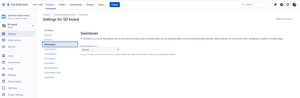

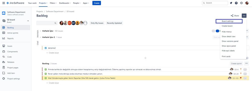

I went Backlog and I only could find Board Settings. I clicked Board Settings. And below screens opened. Then I have no idea how to do it Is there any video to find out it?

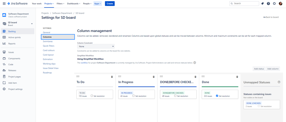

Please supply a screenshot of what appears when clicking on "Columns" instead of "Swimlanes". There you can see if you have any unmapped statuses.
Burçin Sertkaya
March 8, 2021
Hi @Daniel Ebers
Please see ss of Columns as below. I found DONE(CHECKED) as unmapped. So how should I progress?
Kind Regards,
Burçin Sertkaya
Michal Patoprsty
March 9, 2021
Hi @Burçin Sertkaya
Someone created another column with status Done (checked) then removed the column but Status get into unmapped statuses.
I think you have 3 options:
  • Delete Done (checked) status
  • Add another column to which move Done (checked) status
  • Move Done (checked) status to one of the column you already have
Then you should be able to see issues in Done(checked) status on board.
Let me know how it goes.
Additionally,  in my opinion on screen you provided I think it would be better if you used status Review or In Review.
Done Before checked and Done Check are kinda long and confusing for me. (But that is just my point of view )
