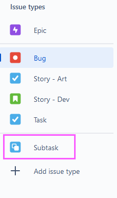

I have created an additional subtask called "Sub-Task - Art" from within Settings > Issues > Subtasks and it can be viewed from within Settings > Issues > Issue Types , however I am unable to find it when configuring fields on a project.
5Ns8HjP
However, only the default Subtask appears.
PnRI5lQ
Adding a new issue type from this menu does not give me the option to categorize the issue I am creating as a subtask, and will only create another standard-level issue.

This happens because your project is a team-managed project. Is a different project type on jira and this project type can not use subtasks or issuetypes 'customized' by the general interface.
If you want to use this specific sub-task, you need to create another project with Company-Managed type.

The first screen image you provided is for defining issue types that can be used only in Company Managed projects.
The second screen image you provided is from the Project Settings > Issues Types screen in a Team Managed project.
At this time it is not possible to create multiple Subtask issue types in a Team Managed project. There is a change request for that here.
https://jira.atlassian.com/browse/JSWCLOUD-20901
If you are using a Team Managed project you won't be able to create addition issue types at the Subtask level. To use the additional Sub-task isssue type you defined in the first screen, you would have to migrate to using a Company Managed project.

Thank you very much for the swift response and I very much appreciate the link to the relevant change request! This explains everything I need to know.
