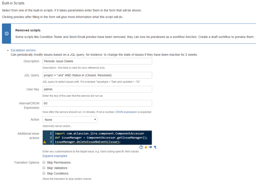

With ScriptRunner you can configure Escalation Service that can run periodically and remove all the issues found by defined JQL query - see the screenshot of example configuration:
jira_periodic_bulk_delete.pngAbove example will run every 60 minutes and delete all the issues found by following query:
project = "Jira" AND Status in (Closed, Resolved)
Here is the script that performs delete using "silent" deleteIssueNoEvent method which is perfect for automated bulk deletes:
import com.atlassian.jira.component.ComponentAccessor
def issueManager = ComponentAccessor.getIssueManager();
issueManager.deleteIssueNoEvent(issue);
I tested above approach myself and it works.
