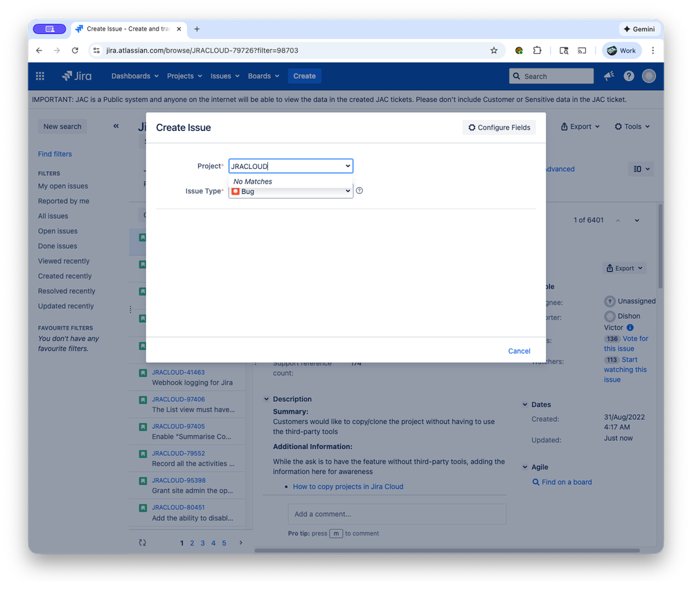

I am unable to create a JRACLOUD bug, it's not in the available list to create. There are others like JRASERVER though. Is there a different bug portal?
