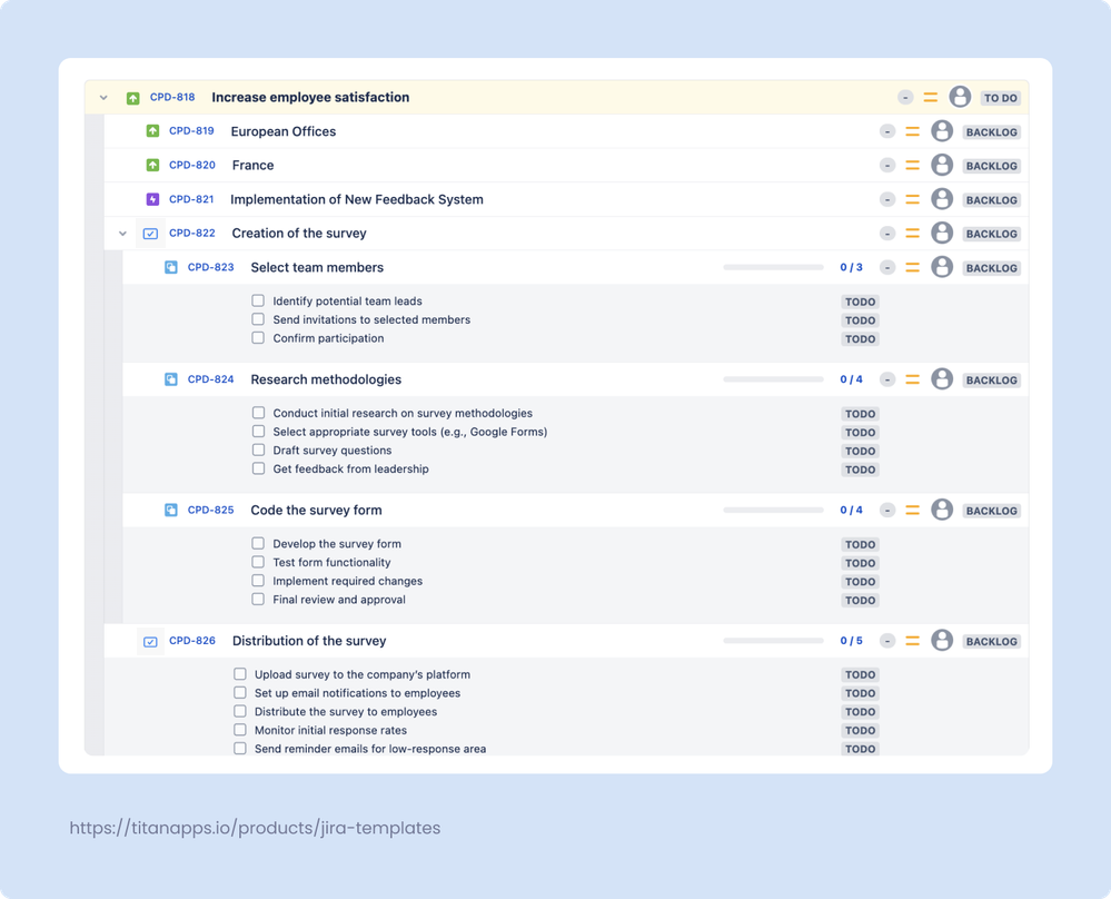

As Valerie already noted, unfortunately, changing the basic hierarchy like that is not possible. So the only way to address this is to find a workaround that would help you accomplish what you are looking for.
A workaround I can suggest is adding checklists inside subtasks - in this case, checklist items will be at the -2 level of hierarchy, and subtasks will serve you instead of tasks.
As a result, the hierarchy will look like this:
Initiative (2) -> Epic (1) -> Story (0) -> Subtask (-1) -> Checklist item (-2)
Our solution, Smart Checklist for Jira, allows you to use checklists as a substitute for subtasks. You can tag responsible people, add deadlines, and set custom workflow statuses for each checklist item. All this (and more) gives you most of the functionality you would get with subtasks, plus some new useful features, such as reusable checklist templates.
Here's an example of how it may look:
Please let me know if you have any questions!

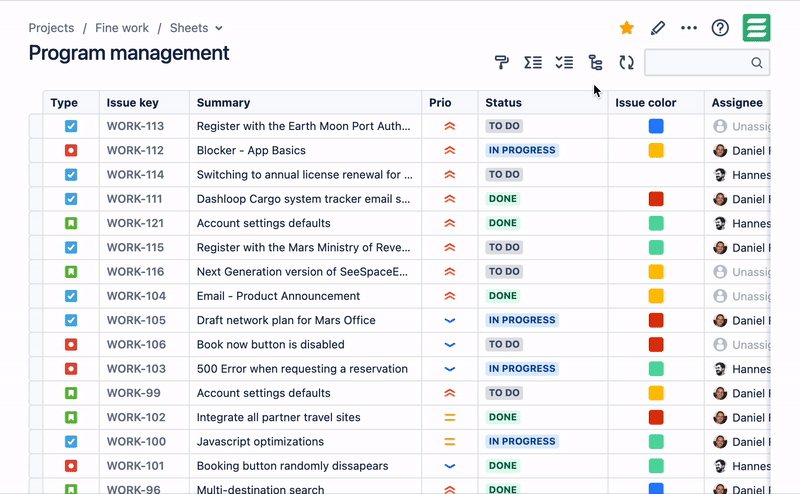

For an improved visual experience, and if you’re open to solutions from the Atlassian Marketplace, you may want to have a look at the app that my team and I are working on, JXL for Jira.
JXL is a full-fledged spreadsheet/table view for your Jira data that allows viewing, inline-editing, copy-pasting, sorting, and filtering by all your work items' fields, much like you’d do in e.g. Excel, Google Sheets, Smartsheet, or Airtable. It also comes with a number of powerful features, including highly customisable issue hierarchies. These issue hierarchies can be based on Jira's built-in parent/child relationships (like task/sub-task, or epic/story), based on issue links of configurable issue link types or any combination of these.
In this example, you can see that a "task" is shown as a parent of bugs and stories, even though they are all "base issue types" in Jira - and that's because there's a certain issue link between them.
I should also add that JXL can do much more than the above: From sum-ups and grouping, to conditional formatting, or inline bulk editing via copy/paste.
