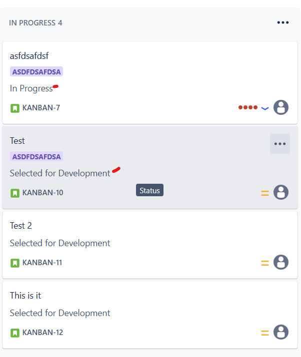

@Preslava Petrova you can add multiple statuses to a boards column. Then when the issues are in any of those statuses, they show up in the column. You can then make the status visible on the card to see what status it is in. Example below:
Ok, I see. I managed to add status by creating a custom field with a simgle option dropdown. I'm not sure if that's the way you did it. I can't find how to customize the cars and make the status visible and all the articles/videos I find are with the old UI.
@Preslava Petrova You can navigate to board settings > card layout and add status. There is no need to have a custom field.
