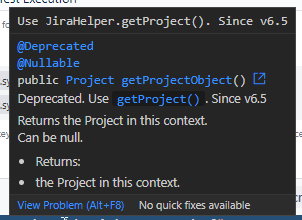

Hi @Nicole Brückner
The approach you are using will not work. I am saying this because in the coding you have used i.e.
jiraHelper.projectObject?.issueTypes in ["Test Execution""Sub Test Execution"]
Firstly, if you are trying to invoke the issueTypes object from the projectObject, this will not work.
The Issue Types need to be invoked from the issue itself.
Instead, you need modify your condition to:-
issue.issueType.name in ["Test Execution""Sub Test Execution"]
I hope this helps to solve your question. :-)

Thanks for the quick response. I tried:
jiraHelper.projectObject?.issueTypes in ["Test Execution", "Sub Test Execution"]
But this is not restricting it to the listed Issue Types, it is generally disabling the Move (so everywhere). Error showed:
 2024-04-24 09_10_19-UI Fragments und 19 weitere Seiten - Geschäftlich – Microsoft​ Edge.png
Your suggestion is providing this error message:
2024-04-24 09_12_09-UI Fragments und 19 weitere Seiten - Geschäftlich – Microsoft​ Edge.png
Thanks for the help :)
