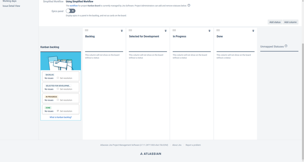

Problem:
I need a project where I can manage a "kanban style" in the backlog. Basically, I want to have more statuses in the backlog. I'm only able to see Backlog and In progress if I use a KANBAN board, and it's impossible to remove the epic panel if I use a Scrum board. I need to see the epics in the backlog view.
We're upgrading to version v7.11.2 of Jira server, but it looks like it's not possible to solve in the new version either, or am I missing some configuration options?
It looks like it's supported (see the "selected for development")?

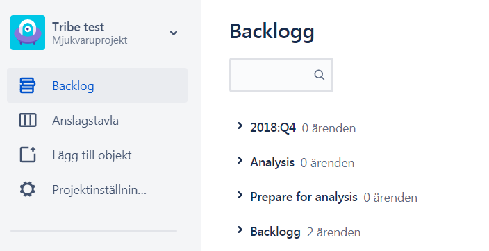

In Jira cloud, it looks like it works just fine if I select to create a scrum project (non traditional). I created several sprints to manage the status/progress in the process:

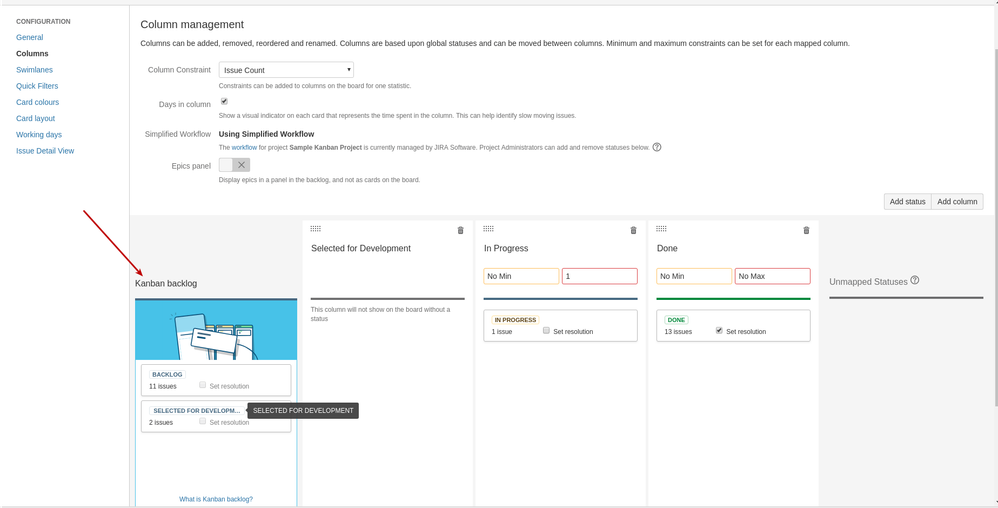

Hi @Johan Jönsson
You should be able to add several statuses in the backlog as shown in the following screenshot:

Mohamed Riza
September 12, 2018
Hi @joesoes,
Can you clarify the Jira version you are using? I have tested this in Jira 7.8 and it works fine without issues:
As you can see in my case, I have added all 4 statuses to the backlog.
Johan Jönsson
September 12, 2018
Jira server v7.11.2. I'm not sure if you uploaded the correct picture. I can only see two statuses in your Kanban backlog and board configuration.

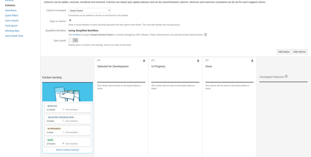

Mohamed Riza
September 13, 2018
Thanks @joesoes. I have updated the screenshot.
I have also tested this on v7.11.2 and am able to configure this as shown below:
Is it possible that you may a screenshot of what you are currently seeing so that we may have a better idea? You may blur out any sensitive data that may be present.
