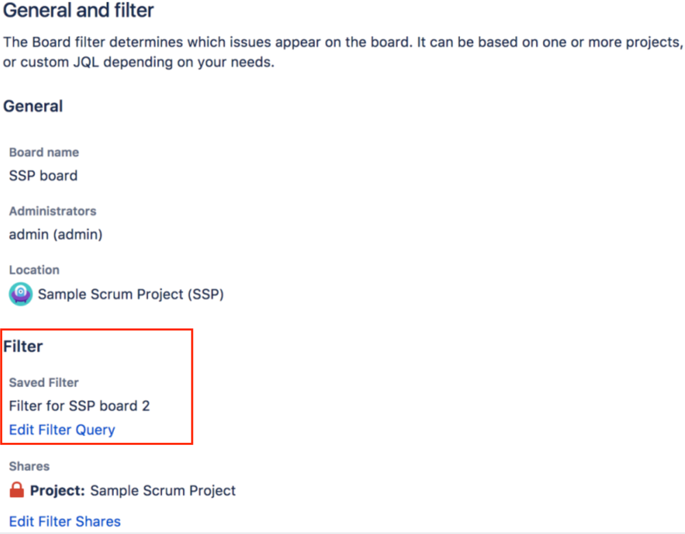

Can you confirm that I make this change by being in the SCRUM board >> Board>>Configure>>  ??

Yes, in that configure menu you should be able to view the underlying filter query and the name of the filter being used.  From there you should be able to edit the filter in the issue navigator and save it.
https://support.atlassian.com/jira-software-cloud/docs/configure-filters/
Just a word of warning though, when editing the filter you can inadvertently mess up the order of the issues on your backlog if you've already ranked them, make sure you don't mess with the ORDER BY statement at the end of your filter.
