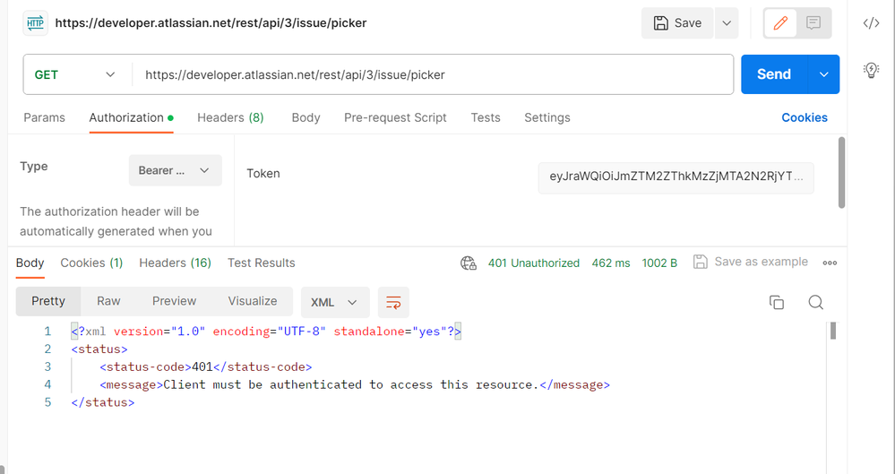

  • Hi. i am calling Jira get issue api with bearer token but not able to get the result but when i used
Sudhir Choudhary
October 30, 2023
Hi. i am calling Jira get issue api with bearer token but not able to get the result but when i used basic Auth it works fine could anyone please suggest how i can call this api using bearer Token.Rest_Api_issue.png

Thanks @Adrien Low _ServiceRocket_  for your Answer, I already implemented Oauth 2.0 but still I am not able to get the correct response from Api as you can refer error screenshot in attachment. According to my requirement authentication should be done with Oauth 2.0 only not with API tokens.

Hello @Sudhir Choudhary ,
Do you have more information on how you have implemented OAuth 2.0?
If you have configured OAuth2.0 EXACTLY according to this documentation, then you should be calling the below URL instead:-
You can refer to the section below for more information on building the request URL:-

Hi @Adrien Low _ServiceRocket_ , Yes i configured Oauth2.0 According to the document but didnot not use cloud id i will try again as you suggested.
