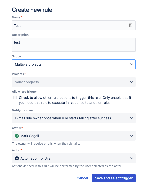

First thing on this is that you would need a multi-project scope in your rule definition so you want to create the rule from global automations:
instance.atlassian.net/jira/settings/automation

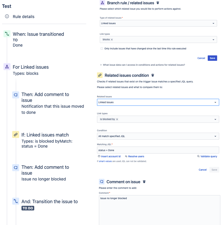

Here's a rule I set up that should do the trick... You'll need to add your depends on link type, but this should get the job done:

HI @Mark Segall thank you for your quick response to my query and much appreciated suggested rule trigger, actions, conditions. Really helped me understand 'how' some of these work in conjunction with each other.
I created the rule as per the steps you outlined above replacing the trigger "When: Issue transitioned to 'Done'" with a manual trigger to test the steps; and I also tested with linked issue being only in my project too.
However I noticed that the rule would only work when manually triggered as an Rule Execution on the issue Foo2 itself.
When I run the rule manually on Foo1, where I would expect the automation to look at each linked ticket on Foo1 itself the rule automation status is 'no action changed'
However if I manually run the rule on Foo2, then the rule status is 'success' and Foo1 has been transitioned to 'To Do'. Same outcome goes when I added other linked tickets to Foo1 alongside Foo2, such as Foo3, Foo4 etc.
I had assumed that the logic would be driven from the rule being executed against Foo1; and hence traversing any linked issues on Foo1 and applying the rule conditions as such to Foo2 or Foo3 etc. etc. ?
Is the above happening because I have replaced the trigger with a manual one for testing please?
Issue Foo1 (my project key) has status On Hold (with one or more linked issues)
  • Is blocked by linked issue Foo2 (either my project key or 'other' project key)
  • Notify when Foo2 status changes
  • When all linked issues on Foo1 which have status 'blocked by' i.e. Foo2, have been themselves transitioned to Done; then
    • Notify assignees that Foo1 is no longer blocked
    • Transition Foo1 to 'To Do' and set priority etc.
Mark Segall
February 15, 2022
Hi @Jonathan Parsons - Did you make sure that your scope and projects were set on the Rule Details screen (see the first screenshot I shared in my original response)?  If you created the rule against Foo2, it will only work on Foo2 by default.
You'll need to ensure the scope is for either multiple projects or all projects and if the former is set, then the Projects field will need to be set to include all relevant projects.
Jonathan Parsons
March 2, 2022
Hi @Mark Segall
Apologies for my late response only I am dependent on a central team to create Global Rules. This has now been done and having tested the rule in our Sandbox its now working across a test sample set of multiple projects. :)
Your help on this has been much appreciated. Thank you
