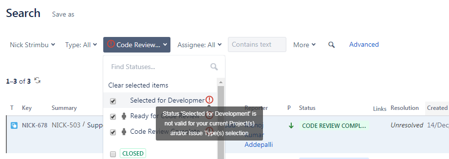

Hi,
Jira cloud issue search error (status is not valid for your current project and/or issue type selection )
please any one help me

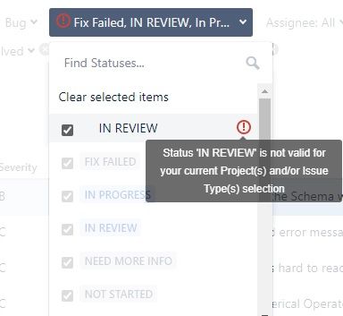

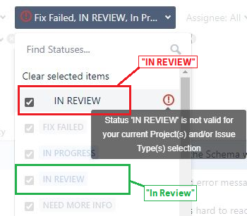

Okay I commented previously... but I managed to finally resolve this issue :D
I found the cause to be from one of our Next Gen projects! They had a column (status) named as "IN REVIEW" which of course created the hidden/backend duplicated status using this case-sensitive title.
As a side note, all other classic and next gen projects in our database use the normal status and column titled "In Review", respectively.
So in order to fix this what I did was:
  1. From the Board view, find and delete the column titled "IN REVIEW" in the next gen project causing the problem
    (you will have to temporarily move all tickets under this to another column/status - so best to note all these tickets prior)
  2. Create the column again, but this time correctly name it "In Review"
  3. Finally move back all those previous tickets that were under this column
Now when I go to any of my Jira searches, this erroneous duplicate status no longer appears! :)
If any admins/moderators see this comment, please note this is a bug with next gen projects that needs addressing. Thank you.

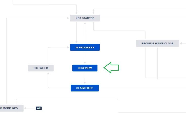

Hello,  I am having the exact same issue even though the Status is used in the Workflow for this Issue Type.
The JQL string is this:
issuetype = Bug AND component = "Game Data / Live Tools" AND project = RC AND resolution = Unresolved AND status in ("Fix Failed", "In Progress", "In Review", "Lead Review", "Need More Info", "Not Started", "Request Waive/Close", "Requires New Package", "To Do") ORDER BY priority DESC, updated DESC
And the Workflow being used here for Bug Issue Type is as follows:
Please help  : (
