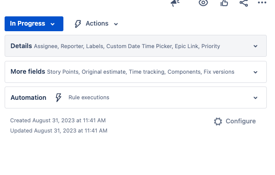

When using the "updated" field in a filter you will be considering the Updated field in the issues. That field is shown here below the panels on the right side of the issue view.
Pretty much every change you can make to an issue will cause the Updated field to be modified.

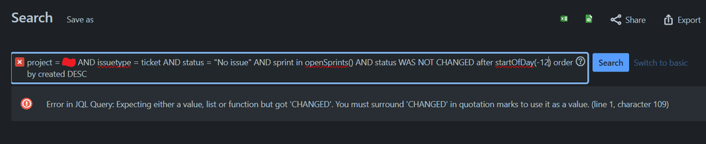

Hi @Trudy P Claspill
I am getting an error , Could you please look into it.
Trudy P Claspill
October 5, 2023
My apologies. I have a syntax error in there. It should be:
status=X and not status changed after startOfDay(-number of days)
