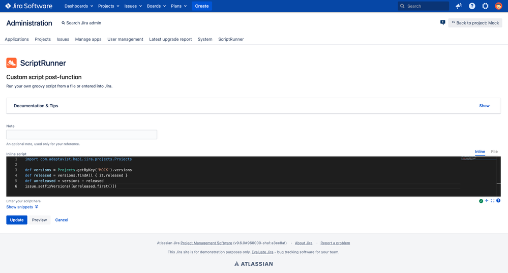

Below is a working example code to update the Fixed versions field with only an unreleased version using the HAPI API.
import com.adaptavist.hapi.jira.projects.Projects
def versions = Projects.getByKey('MOCK').versions
def released = versions.findAll { it.released }
def unreleased = versions - released
issue.setFixVersions([unreleased.first()])
Please note that the sample working code above is not 100% exact to your environment. Hence, you will need to make the required modifications.
This example uses ScriptRunner's Custom Script Post-Function for the Done transition.
Below is a screenshot of the configuration for your reference:-
I hope this helps to solve your question. :-)
