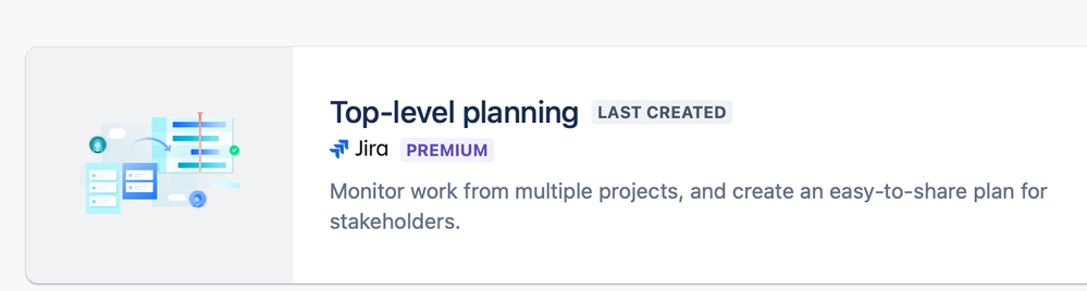

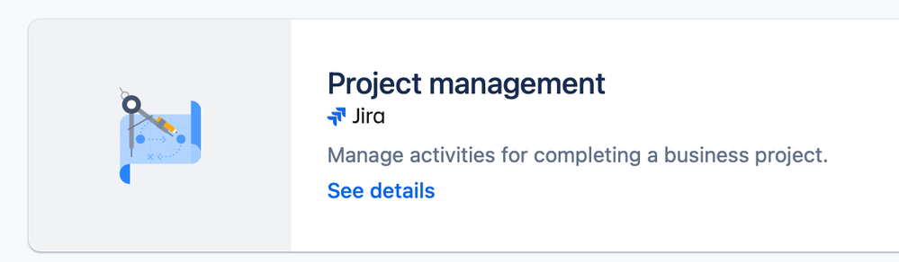

honestly i don't necessarily need a hierarchy level above epics -- i just want to be able to link epics to our goals/initiatives/priorities. i am using these two projects attached in screenshots. Screenshot 2025-01-13 at 3.47.10 PM.pngScreenshot 2025-01-13 at 3.47.17 PM.png

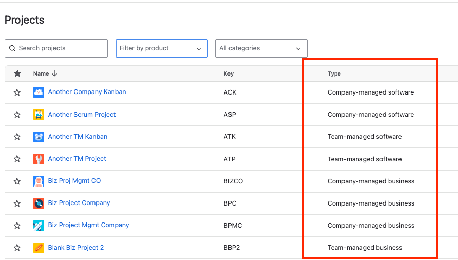

What you showed in the images you provided are the Project Templates you used. What I need to know is the project Type. Get that information from the View All Projects page under the Projects menu. Example:
The "Top-level Planning" template generates a Company Managed Software project.
The "Project Management" template generates a Business project which may be either Team Managed or Company Managed, depending on the choice made by the person who created the project.
  • Note that Business projects don't directly support the Scrum/sprint methodology with their boards. You either have to use a Software project, or create a separate Scrum board based on a saved filter that includes the issues from your Business project.
