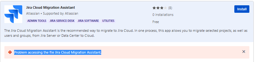

I was able to verify that i have the trial server. I am currently trying to add the Jira Cloud Migration Assistant and receive an error "Problem accessing the file Jira Cloud Migration Assistant." Any additional help is greatly appreciated.
What version of Jira Server are you running? JCMA is already bundled in Jira versions 8.14 and above.
Version 8.8.1
I don't see the application listed. Thank you for your assistance.

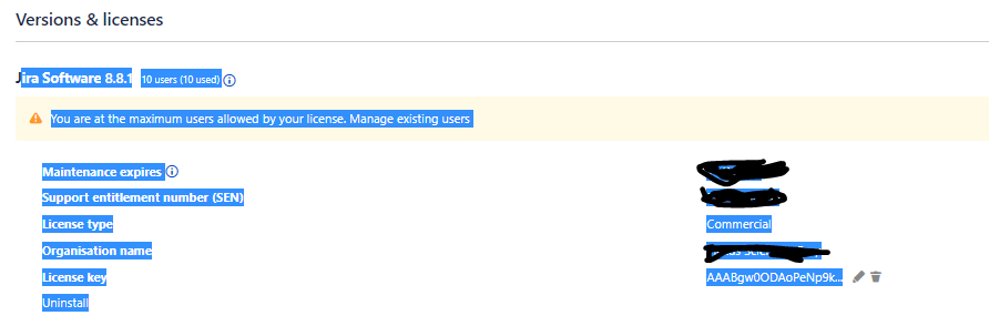

Can I see the license information? Just a screenshot from the Admin cog -> Products page should work. You can redact any sensitive info.
Well you redacted the expiration date for maintenance. Are you under active maintenance? You can't migrate if you aren't.
yes it is expired. Maintenance expires 11/Apr/21. It doesnt make sense that i cant migrate if its expired since i wont need Jira server once i migrate. Am i missing something?
Think of it this way:
Migration is a complex process in terms of both Jira data and 3rd party app data that brings with it a lot of risks. For some of these risks, Atlassian has released newer versions. For you to upgrade your server to those newer versions, your maintenance must be active.
Anyway, you can get yourself current on maintenance (temporarily) by installing a Data Center trial license. Once you install, the clock is ticking.
Details are here: https://support.atlassian.com/migration/docs/migrate-to-cloud-with-an-expired-server-license/
