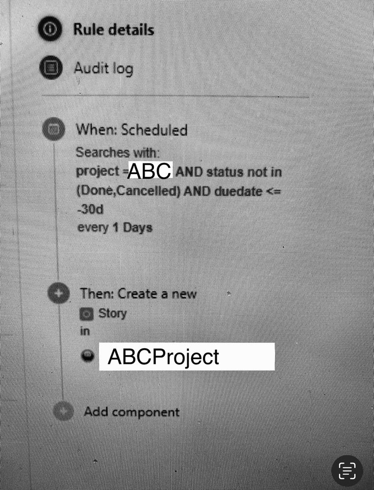

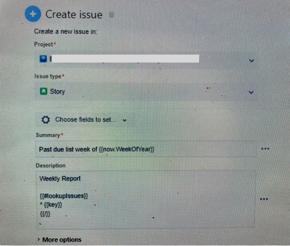

Absolutely stumped trying to create a filtered list in 1 Card for a Kanban
Every Monday
Create 1 card of all the late cards for the week
Link all the late card to this 1 card
The logic in place create a card for each late card. I can use this logic if I’m emailing  multiple late notifications, but the manager just wants 1 card a week.
I have tried in a branch & without a branch
Most recently created issue, current issue
So far the schedule & filter works.
When: Scheduled Every Mon
filter: Project = ABC AND Status not in (Done, Cancelled) AND duedate <-1
then Create a new
Story
Edit Description
{{#lookupIssues}}
* {{key}} {{issue.summary}}
{{/}}FDAE573E-5951-4FD2-8A64-A0ECA65137DE.jpeg97FA50AB-B9ED-48F1-A146-7C9BF3751061.jpeg

Are you trying to create a weekly report of items which were due in the past?
Perhaps try a saved filter, and allow people to subscribe to it to get a single email with the items rather than using an automation rule to create an issue to track the items.
If you still want to use an automation rule to send that email report, that is possible.  What version of Jira do you have: Cloud, Server, or Data Center?  That will impact the approach used to send the email report.

I think it’s cloud. I proposed subscribe but the manager is set on having it in a card. He wants all the past due cards linked to his weekly card.

Please consider meeting with that manager and your team agile coach (or Jira admin) to understand why they want an issue on the board to manage this.  That may reveal another approach, such as a dashboard or quick filter for the board.
The reason I suggest this is:
  • This situation indicates a training opportunity for the manager to learn more about Jira usage, Kanban practices, and team autonomy vs. accountability
  • The team uses a board to manage their work and make progress visible.  Adding an item to the board for the sake of reporting will cause confusion.
  • As your rule is scheduled to run daily, this will continue to add new items...some containing the same Jira issues as the prior days
  • Adding reporting items to the board will inflate / alter the built-in Jira reporting, making it harder for the team to use those reports to improve how they work
  • Finally as the team is using Kanban, this approach is in opposition to a fundamental idea of Kanban methods: pulling new work versus pushing it on the team.
Assuming you have the conversation above and still want to do this, try adjusting your rule as follows:
  • trigger: scheduled with no JQL
  • action: lookup issues with the JQL you were using
  • advanced compare condition:
    • first value: {{lookupIssues.size|0}}
    • condition: greater than
    • second value: 0
  • action: create your issue
