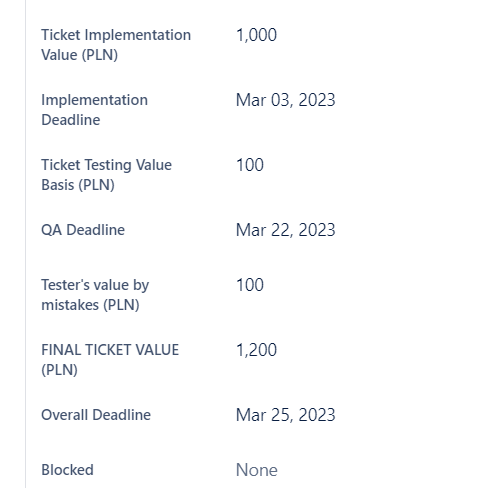

I'm quite newbie to jira but spend two weeks already on this task without success - Im trying to create the automation which will be counting dynamically the following fields:
in the following way - PM is adding Implementation Value and testing value basis, then during the process if tester found mistakes he can add value to the "Tester's value by mistakes" field and if he is updating value there it should substract that value from field "Ticket Implmenetation Value" and show the sum of all three fields in FINAL TICKET VALUE
The main issue that if after the first change - we want to adjust the tester's value by mistake field it substracts again the same value from the ticket implementation value while we want it to adjust difference only with the previous value. Also if we want to correct/remove value from tester's value by mistake field to make sure its added back to the ticket implementation value field and calculate properly Final Value.

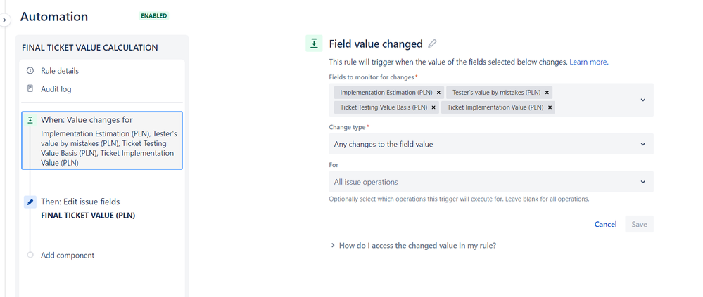

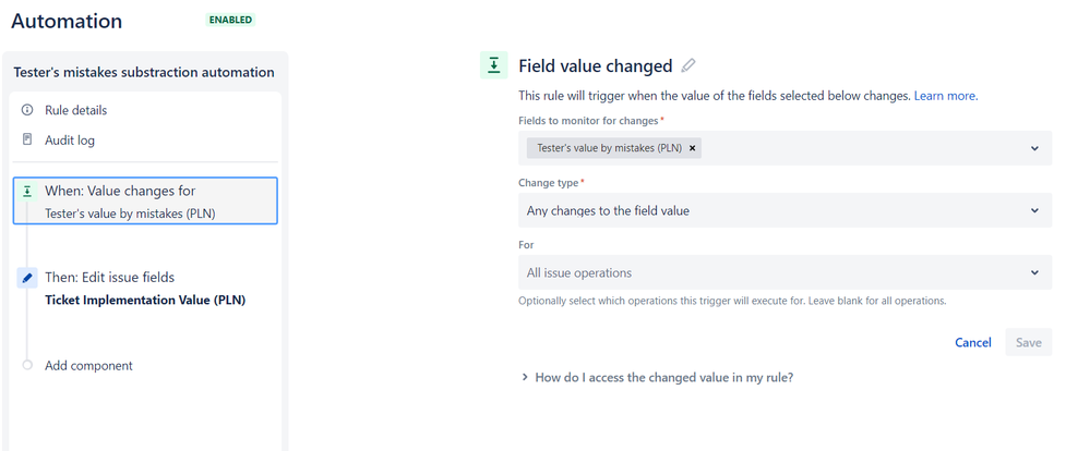

Currently we have two rules (which are basically wrong as they aren't proprly calculating it):
1st: called  "

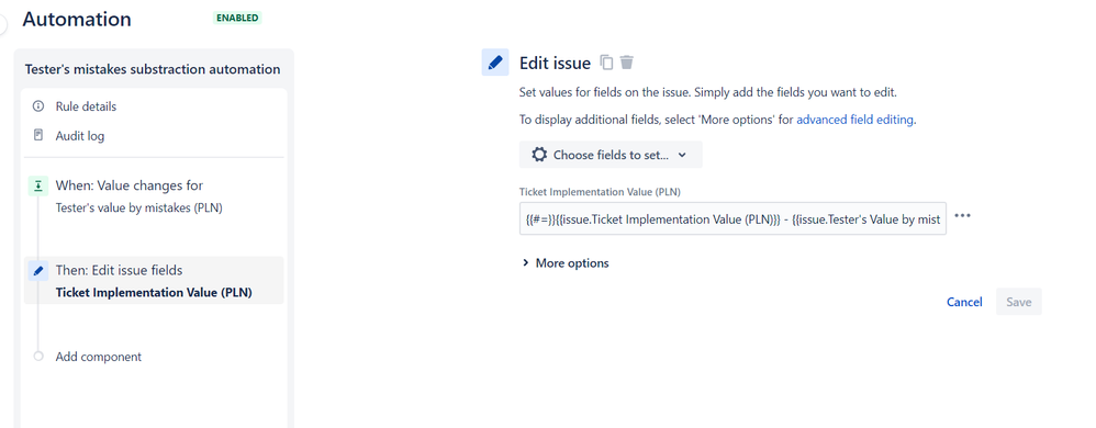

Tester's mistakes substraction automation" making calculation as following - if there is any change to "Tester's value by Mistakes (PLN)" field then make the following calculation: Ticket Implementation Value (PLN) equals {{#=}}{{issue.Ticket Implementation Value (PLN)}} - {{issue.Tester's Value by mistakes (PLN)}} {{/}}
We want to update the field to Ticket implementation value to decrease be value provided in  tester's value.

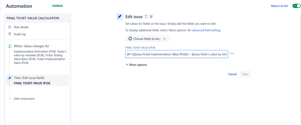

2nd: called "FINAL TICKET VALUE CALCULATION" and triggers if there is any change to the fields: "Tester's value by mistakes (PLN)"; "Ticket Testing Value Basis (PLN)"; "Ticket Implementation Value (PLN)"  then to run the follwing calculation: FINAL TICKET VALUE (PLN) equals {{#=}}{{issue.Ticket Implementation Value (PLN)}} + {{issue.Tester's value by mistakes (PLN)}} + {{issue.Ticket Testing Value Basis (PLN)}} {{/}}
To sum up all these fields.

Thanks for the information. But can you share actual screenshots of the rule?
Taras Korobko
May 3, 2023
Hey John,
Sure if it will help - here are he two rules I've provided details previosuly:
Formulas pasted in my previous comment. If you need anything else - let me know.
Thank you in advance :)

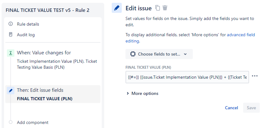

Kelly Arrey
May 4, 2023

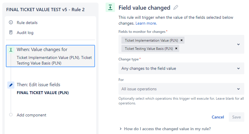

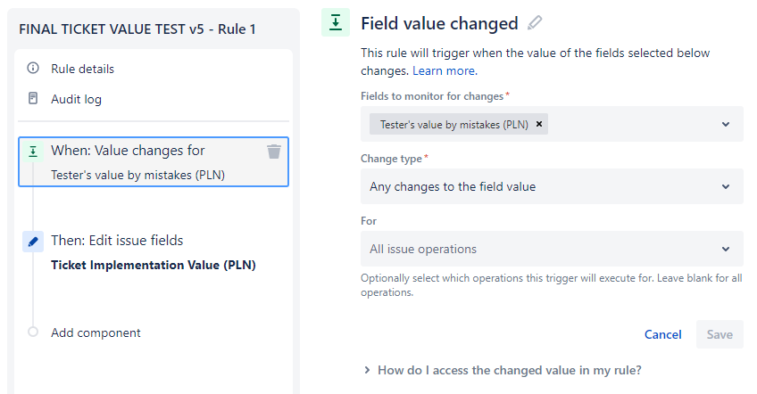

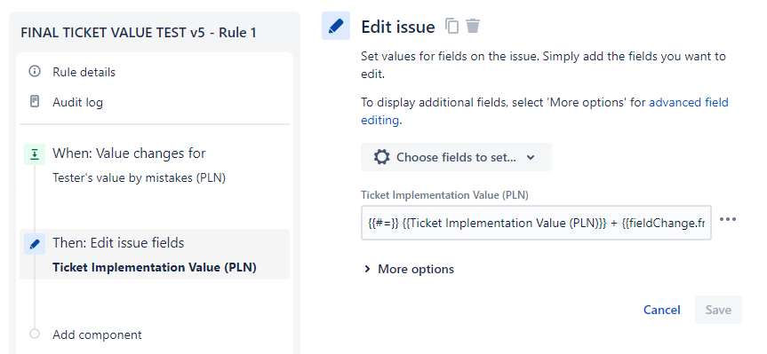

Hi @Taras Korobko with some help from Atlassian support, I arrived at the following two rules:
The important parts are setting the values of the fields:
Rule 1:  Ticket Implementation Value (PLN):
{{#=}} {{Ticket Implementation Value (PLN)}} + {{fieldChange.fromString}} - {{fieldChange.toString}} {{/}}
Rule 2:  FINAL TICKET VALUE (PLN):
{{#=}} {{issue.Ticket Implementation Value (PLN)}} + {{Ticket Testing Value Basis (PLN)}} + {{Tester's value by Mistakes (PLN)}} {{/}}
| The key point is that {{fieldChange.fromString}} and {{fieldChange.toString}} refer to the
| field you're triggering off.
HTH,
Kel
Like • Taras Korobko likes this
Taras Korobko
May 4, 2023
@Kelly Arrey You are my hero!!! This worked out! :) Thank you so much!

  1. When Ticket Implementation Value (PLN) changes, calculate FINAL TICKET VALUE (PLN)
  2. When Ticket Testing Value Basis (PLN) changes, calculate FINAL TICKET VALUE (PLN)
  3. When Tester's value by mistakes (PLN) changes, calculate FINAL TICKET VALUE (PLN)
