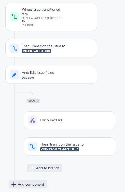

Here is the flow:

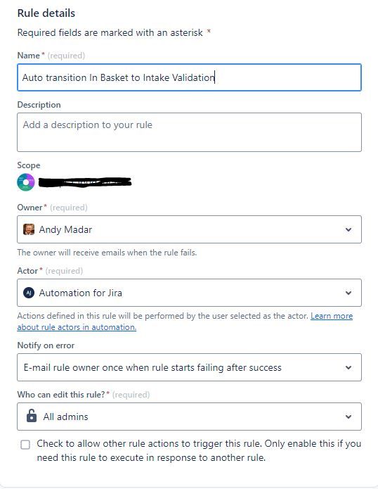

Rule details:

Trudy P Claspill
June 10, 2024
Hello @Madar, Andrew
Can you show us the entire output of the Audit Log for the rule execution? You have two transition actions in your rule, and we can't tell from what you provided which one is throwing the error.
I notice that after the trigger, which is an issue transition, you are transitioning the trigger issue to another status and updating field(s) in the trigger issue. After making changes to an issue in a rule, if you want to later reference that changed information you should use the Re-fetch Issue action to make sure your rule has the current information cached.

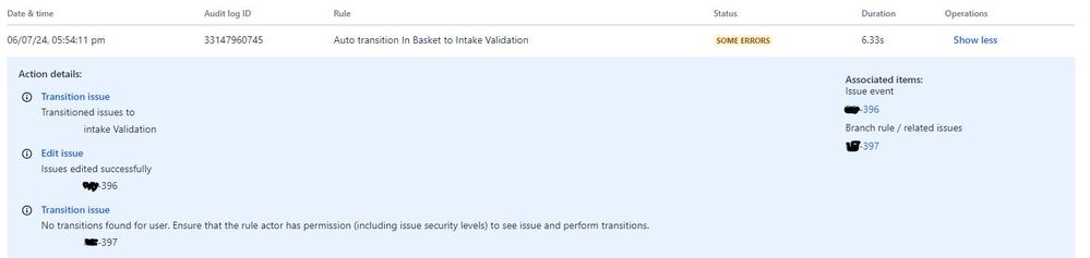

Here is the entire error.

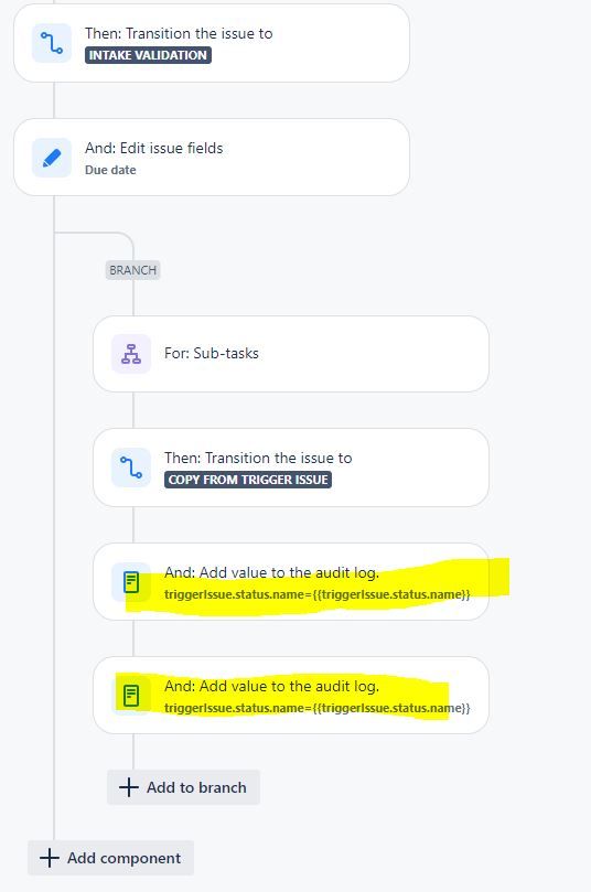

I added the log action you requested.
Trudy P Claspill
June 10, 2024
Thank you for the additional information.
From the Audit Log details you shared we can confirm that it is the attempt to transition the subtask that is failing.
What output are you seeing in the log with the addition of the Log actions?
Does the workflow for your subtask include the Intake Validation status?

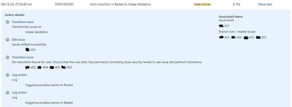

Madar, Andrew
June 12, 2024
Hi Trudy, so the rule ran and I see the log action update showing In Basket

Trudy P Claspill
June 12, 2024
To which status do you want to set the subtasks; In Basket or intake Validation?
In the workflow do you allow issues to transition from any status to any status? Can you share the workflow diagram with us?
What are the status values for the subtasks when this rule execution started?

Trudy P Claspill
June 13, 2024
As indicated by the Log action, the status value that the subtasks are attempting to be transitioned to is In Basket rather than Intake Validation.
You are changing the trigger issue to Intake Validation as part of the rule. If you want to get that status by copying it from the trigger issue, you will have to add a Re-fetch Issue action after the step where you transition the trigger issue to that status.
But, if you know you want to transition the subtasks to Intake Validation, why not explicitly select that in the Transition Issue step?
Correct that problem and then see if the rule runs correctly.
