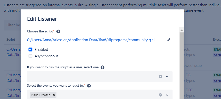

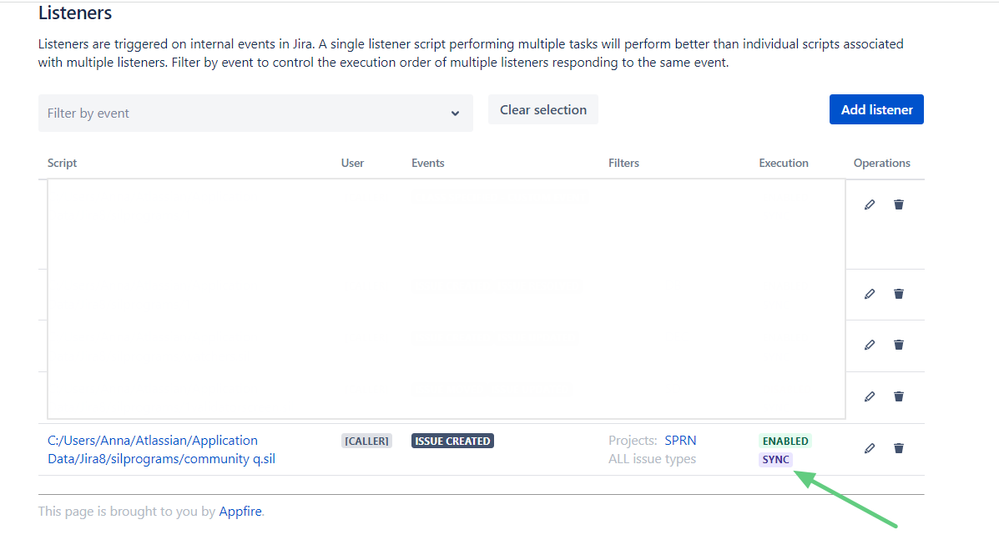

When you wrote that it`s a level field, I was pretty sure that it may be a reason. So because of curiosity, I performed tests with the label and it works on my end as expected. Therefore, it should be something else so I started to think about differences we may have in configuration and I found something. Could you please ensure that your SIL Listener is Synchronous :2023-05-12 13 24 53.png
So the settings should look like this: (without checkmark near Asynchronous )
I think it may be the reason because since I`ve changed it to Async, I received the same behavior as you had - the comment was added but the field value was not updated.

Arun Chatterjee
May 12, 2023
hey, thanks for responding again. you've been really helpful!
as for the sync setting, it seems to be in "Sync" as shown in the image above. We never have that ticked to be "Asynchronous" in our other scripts.
i thought may be doing "Async" will work, but apparently not. I just tried. No bueno :(
