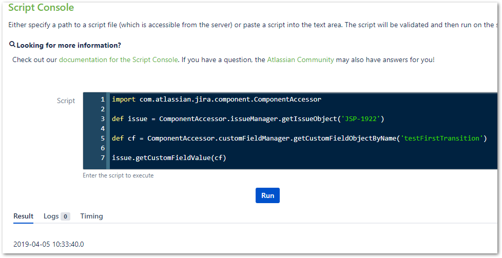

All the scripted fields are still available via rest and java api.
The only place you can't retrieve those fields is if you try to look directly in the database.
So just retrieve the custom field like you would any other custom field:2019-07-08 09_35_02-Script Console.png
