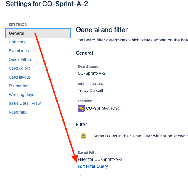

To edit the filter for a board,
1. click the ... button in the upper right corner while the board is displayed.
2. Select Board Settings.
3. Select the General tab.
4. Click Edit Filter Query

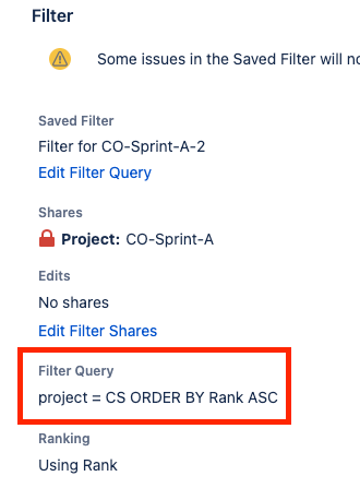

If you scroll farther down on that same screen (shown above) there will be a field that shows what the filter settings are currently for that board.
If you show us the filters for each board we can provide more specific guidance on how you might need to change them.

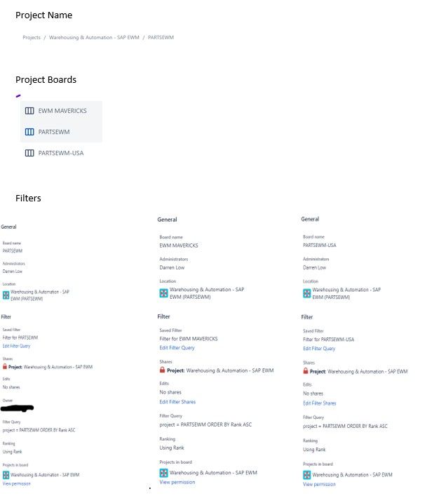

Hi @Trudy P Claspill Your explanation helps a lot.
Here is a screenshot of my filters
Board A = PARTSEWM
Board B = EWM MAVERICKS
Board C = PARTSEWM-USA
Your three boards are all using the exact same criteria in their filters:
project= PARTSEWM ORDER BY Rank ASC
So, all the boards will display the same issues - all the issues in the PARTSEWM project.
If you want to have the boards display different issues, you need to change those filters.
