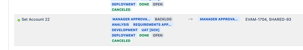

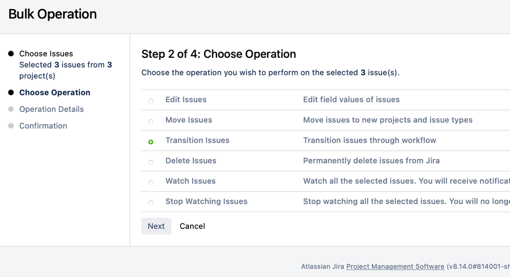

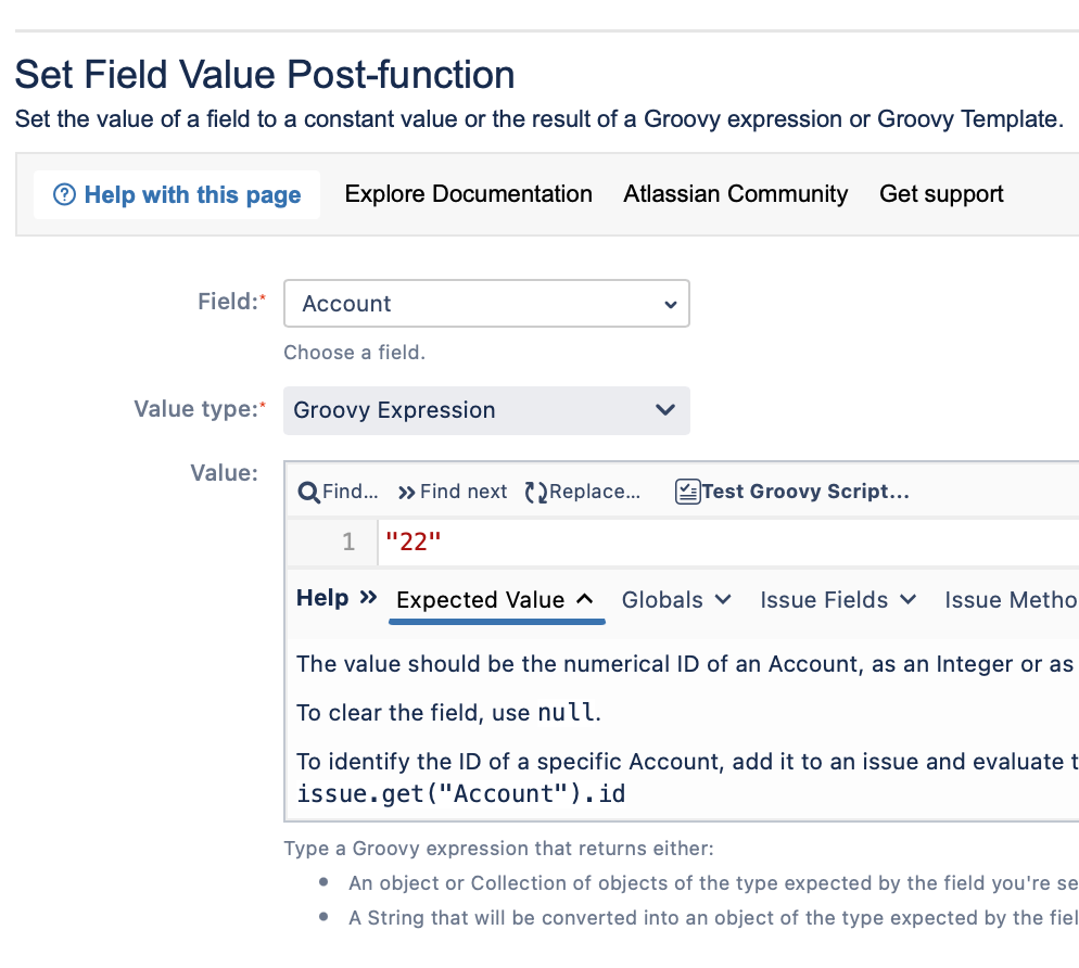

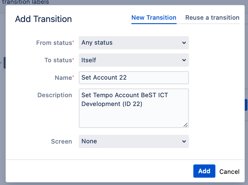

You can try workaround
1. Transition - from any to itself
2. Post Function - Set Filed Value
3. Bulk Change - Transition Issues
