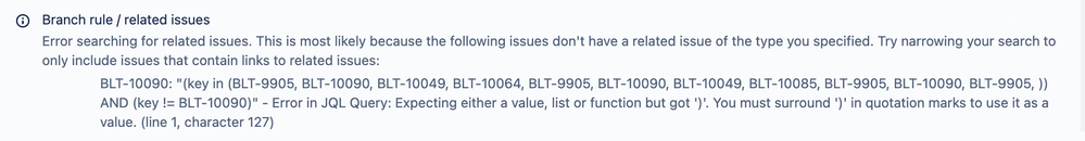

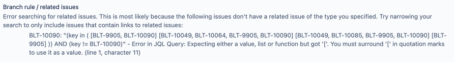

I need help fixing this jql/smartvalue automation. What I am trying to do is to pull back the links on the linked issues.
#lookupissuesbrings brings back 5 arrays of ticket keys. (picture 1 & 2)
Screen Shot 2022-07-20 at 9.32.20 AM.pngScreen Shot 2022-07-20 at 9.31.11 AM.png

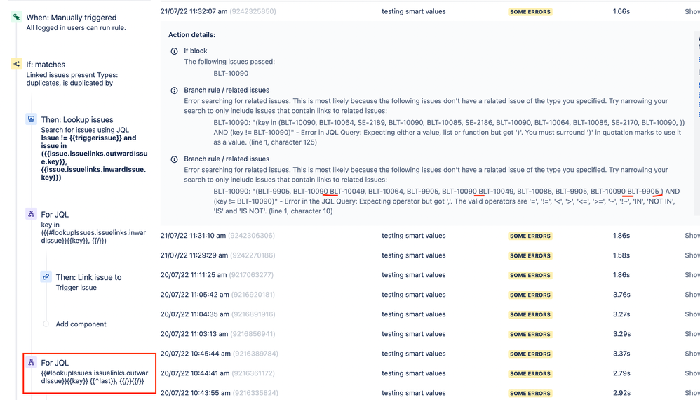

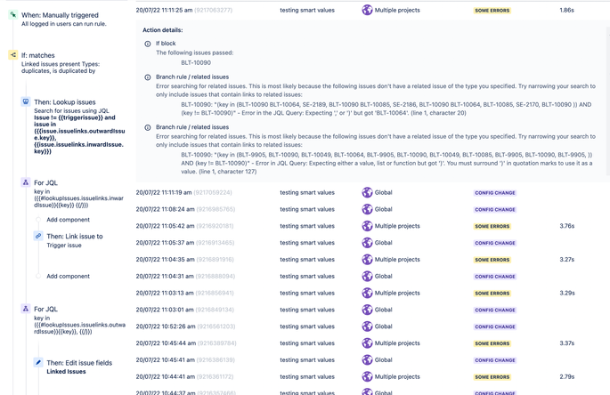

I figured out how to get the values out of the brackets/arrays. (picture 3 & 4)

But I can't figure out how to get rid the last comma before the parentheseis. I tried "{{^last}}," but that takes the last comma from each array. I have been working on this for waaaaaaaaaaaaaaaaaay too long and cannot figure how to remove it.
I have tried putting the lookupissues in a variable as well, I can't figure why that won't work. I have tried splitting key for the smart value, that won't work for me either. But it is driving me bananas.
