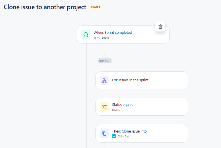

I want to automation this
When I complete the sprint, clone the story issue to other board, where status is done. This part I can solved it as you can see in the picture below.Capture.PNG
 But the main point is the parent issue or epic is still link to the source board, which is not right, it should create a new epic with the same summary on destination board, if it doesn't existed. So from this pain point, my thinking of this solution is I have to make this automation to check the existing of the parent issue or epic on the destination board before cloning epic, but if it exist, not proceed. Then clone the issue or story issue to destination board.

I need this because my organization divided product process into two part and two board, design sprint and development sprint. So I just want the story card from design sprint that is completed and approved, to auto duplicate to other board, so I don't have to double work.

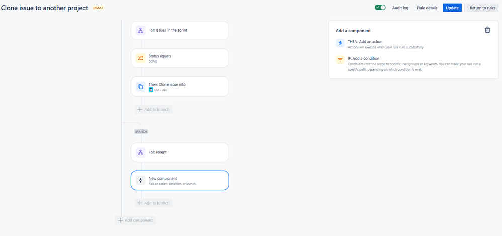

At this point, what should I pick and if it need to be lookup issue, can you help me with the JQL?

You need first to create a variable.
The variable should be the summary of the parent.
The JQL in the lookup should be project = "CM - dev" and type = Epic and summary ~ {{<variable>}}

So first, I select then and use action "Lookup JQL"?
Then type this in the JQL prompt field.
Am I understanding correctly?

No, you to create a variable and use this variable in the lookup.
This article should help you.
