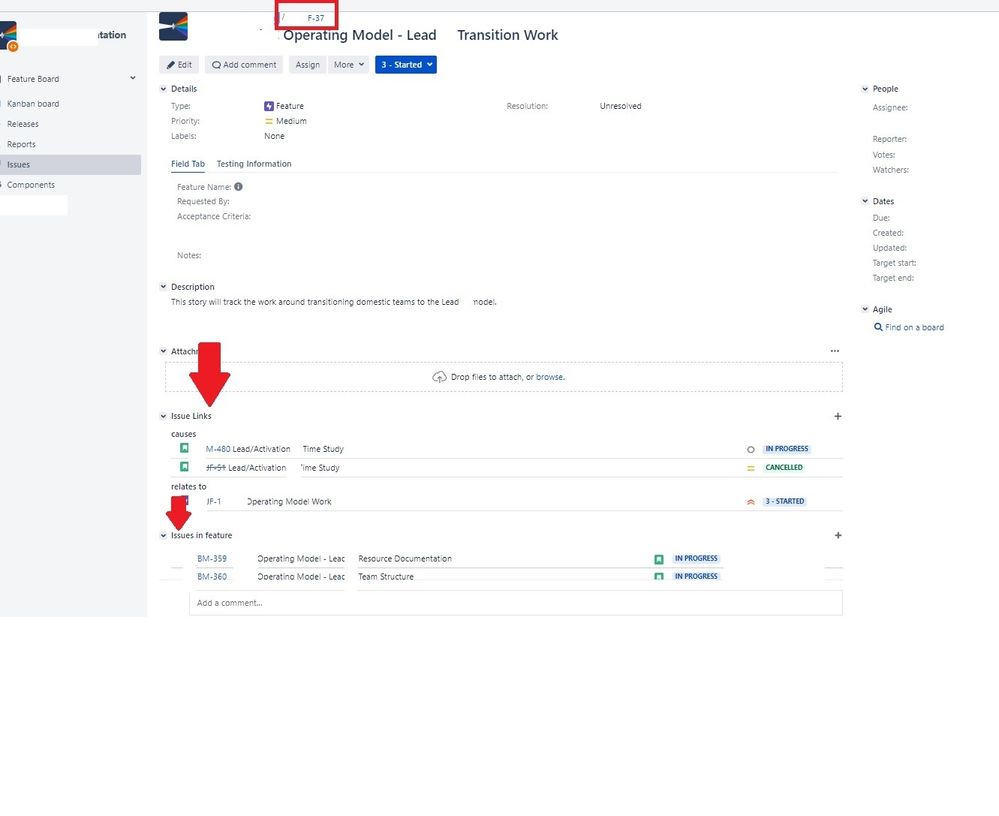

I am fairly new to Kanban and have been building out multiple charts/graphs in Dashboards that our upper leadership can quickly load and review everything. So far all is well and is producing everything we need. There is however one graph I'd like to create and are having difficulties getting one very important data point to load.
Background: We have 2 projects. 1 used for creating "Features" and the other "Stories". Feature being the main project and stories are used for creating sub-issues that are linked to a feature. In the attached screenshot#1, you'll see this is a main issue (feature, end with JF) and where the red arrows are you'll notice "Issue Links" (which I can load into my graph just fine). Main issue here is that all of the stories (ones that end in BM which is under Issues in feature), those I'm not having any luck pulling in.

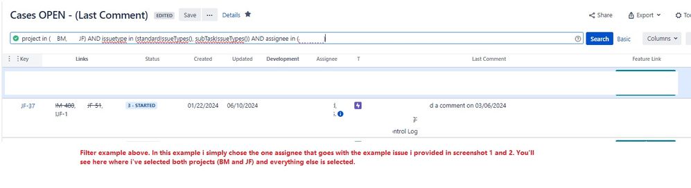

*I added Screenshot#2 just to show how the chart looks like in my dashboard and the results I'm getting.
Lastly, from a Filters perspective I am using basic formatting and not advanced. I do have both projects selected. I have tested dozens of columns to try and see if it would load these stories, but nothing has worked thus far. There are over 100 columns so it's very possible I've simply chosen the wrong one.

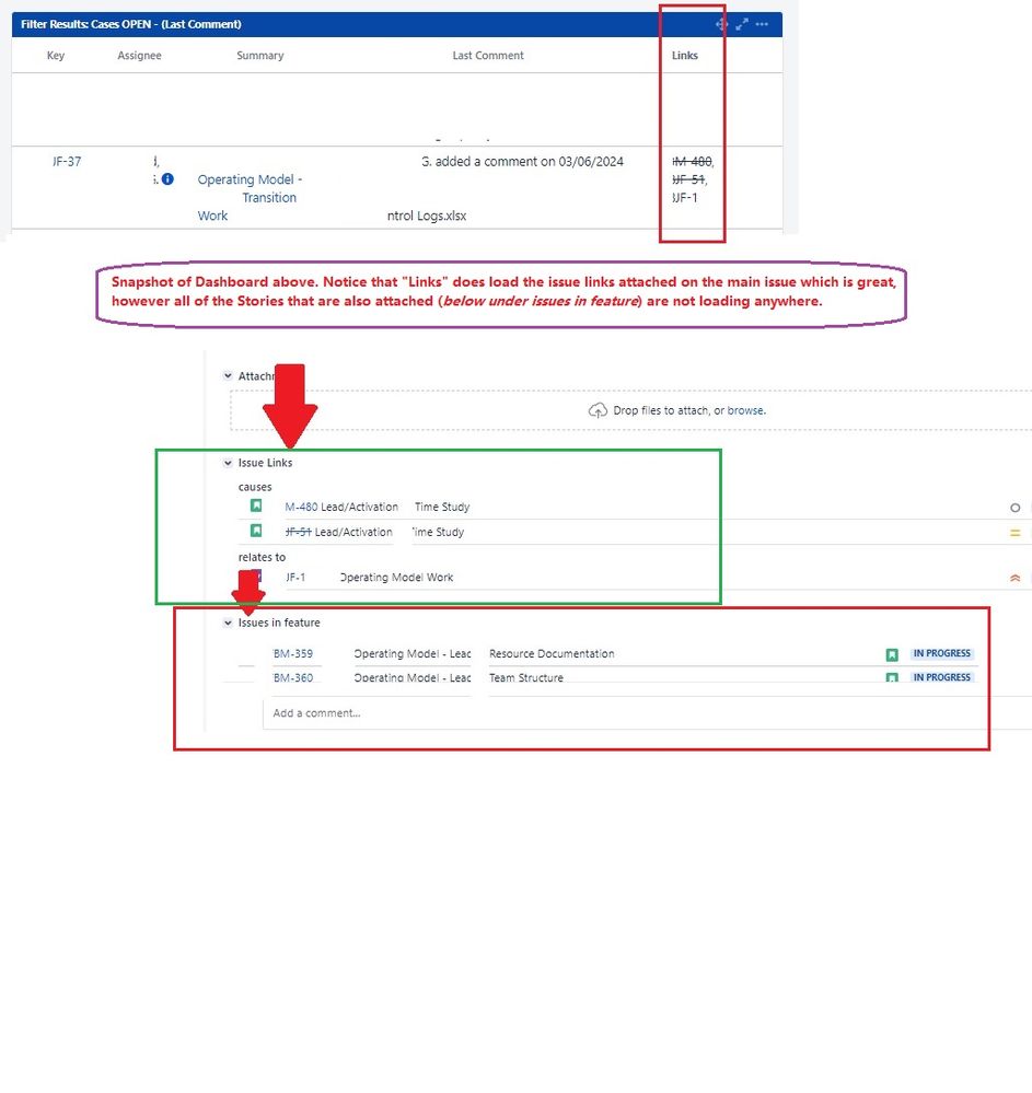

Does anyone know of a way I can generate the stories when creating a filter? Screenshot#3 will show how the filter looks.

Coming to the dashboard I'm assuming you want to see something like below:
* JM-1 (In Progress) : Sub Stories Progress 50%
For this view, it isn't available out of the box from what I've seen, you'll need to automate a custom field to calculate the value based on ticket count and how many have been completed.

Take one JM issue for example…i have 10 stories linked to it. Of those 10, 5 are completed and done and the other 5 are still pending research. Again, when you navigate to the main issue (JM) and scroll down you will see all 10 of these linked stories including the status.
in dashboard I’m not so concerned about wanting to see the status of each story. I simply want to have a snapshot view of all my main issues (JM) and to the right somewhere, it generates all stories linked. Having a hyperlink to each story so i could click from the chart and it route me directly into that particular would be ideal.
In order to accomplish this are you saying I would need to create some sort of automation? I’m a bit puzzled as to why this data isn’t generating regardless. If you click on the main issue (JM) and scroll down, if there’s a linked story it will show (see first screenshot in original msg). They generate under “Issues in feature”.
