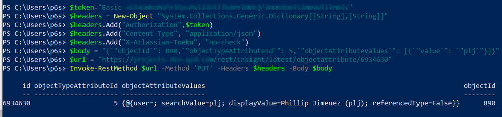

Here is an example that worked for me in powershell:
Matt Webb
June 30, 2022
Thanks for sharing that Peter-Dave, that's cracked it.  Partly it was the JSON type in the header (it works without the token/toekn bit).  Partly it was me getting my double quotes and single quotes mixed up in the end.
Note to others I had to use a searchValue that on my system was "JIRAUSERXXXXX".
Thanks for persevering with me Peter-Dave.
