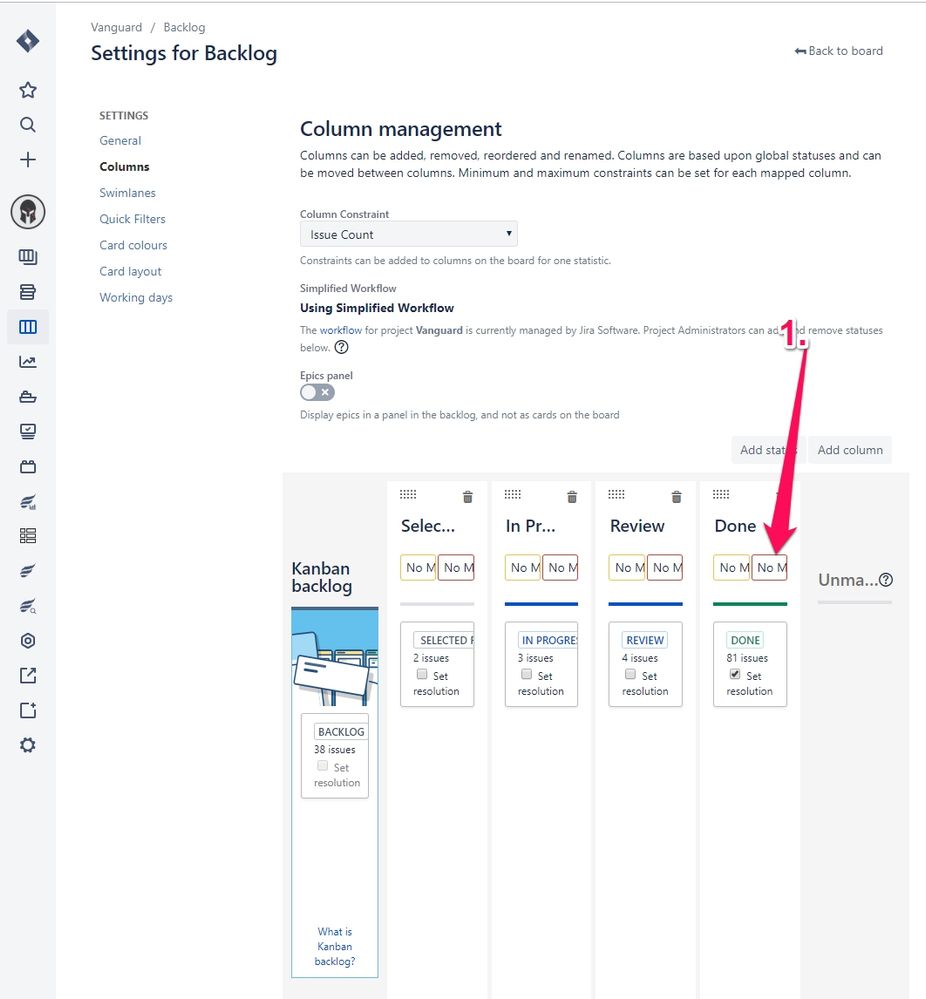

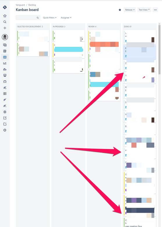

My project is set up as a "Kanban backlog" in Jira, and one of the issues I have is as I transition cards to "Done" in the Kanban board, the "Done" column just keeps stacking up (see the most right-hand column in IMG1 below), and worst of all it naturally sorts itself from oldest to newest, meaning the most recently Done cards always end up at the bottom and is lost out of focus when working on the board.
What I'd ideally like is to have just this column sorted from newest to oldest. Does anyone know how to do this?
I've also tried adding a "Issue count" constraint via Settings (see IMG2) and setting a 'max' number of issues to show, but this doesn't help because it then shows the top oldest cards.
Does anyone have any other alternatives to this problem?
 IMG1:
IMG2:

You're talking about 2 different problems :
  1. The order that items appear in the Done column (and I'm assuming other columns as well)
  2. All Done items stacking up in the right hand column
For 1., you will need to look at the Board filter (or sub-filter)  - I have never heard of it doing that, usually it is in priority (rank) order. Show us your filter and we may be able to suggest something.
For 2., at the top right hand side of your board is a Release button. This is used to group a number of items together via a fixVersion and once released, they will disappear from the board. You can always then go to the Releases section
to view the items that have moved off of the board
Akmal Fazleen
November 22, 2018
Thanks @Warren that's really helpful.
Getting them into "Releases" and marking them as released solved the issue. The Jira board makes a lot more sense to me now.
