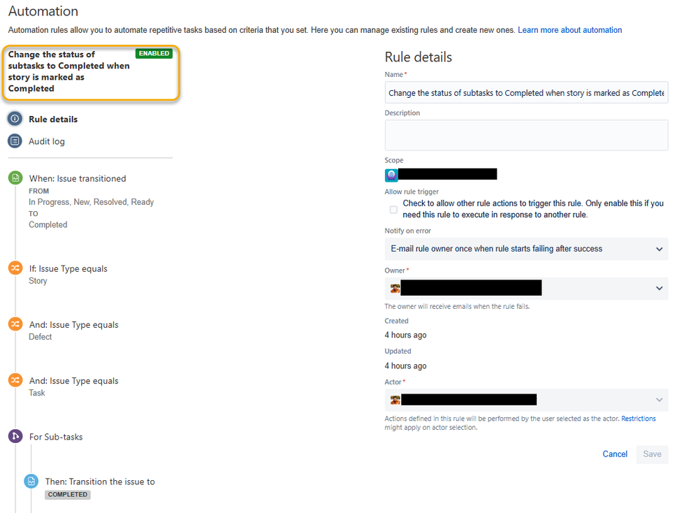

I am creating an Automation Rule for the below requirement.
Requirement:

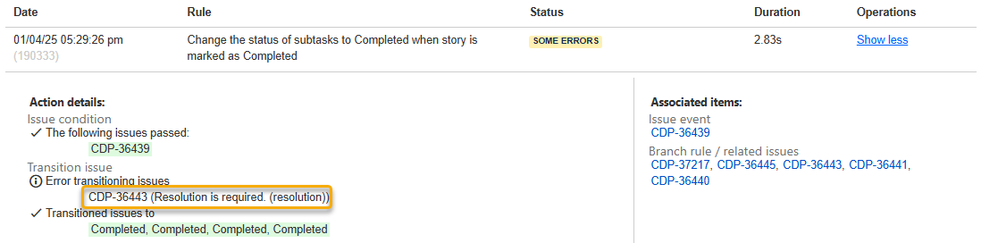

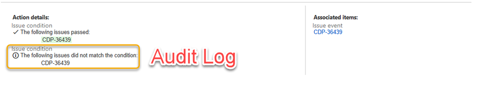

Whenever a User Story, Defect, Task status is changed to 'COMPLETED'. I need to update the Subtasks underneath that story, defect & tasks are also marked as 'COMPLETED.
I created the rule, but it is throwing me an error for the required action.
I have attached rules details in a screenshot, also the 'Audit Log'. Please refer to that and let me know, you have any solution for this.

Hi @Vijay Kumar
The way you rule is written, it will halt on the first condition not met.  Please remove two of the conditions, and change the first one to this:
And inside of the branch, you may want to add a condition so the Subtask does not transition when it is already Completed.

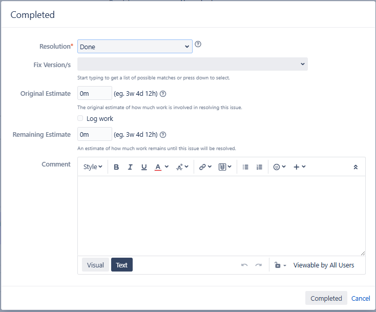

Now it started working, however it failed because of some other reason. Whenever we are closing a Subtasks, we need to update the 'Resolution' field as 'Done'. We have one step in between. Because of this, for one of the sub-tasks it couldn't update.
Is there a way we can override this step? or can ignore?
Also, i am not sure about 'how to add a condition, so that Subtasks does not transition when its already completed. Please suggest on this as well.

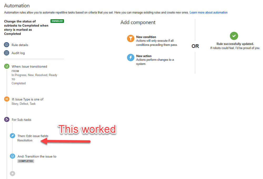

Mikael Sandberg
April 1, 2025
So before doing the transition of the sub task, add an Edit issue action that sets the Resolution field.

Bill Sheboy
April 1, 2025
Or, in the Transition Issue action, select and set the Resolution at the same time.

Vijay Kumar
April 1, 2025
@Bill Sheboy @Mikael Sandberg  Hmm...lemme try & get back to you guys!
Vijay Kumar
April 1, 2025
You both are incredible! Thank you so much for your help. You have no idea how much this means to me and how much time it saves. Thanks again, and I hope you have a fantastic rest of your day!

Is the work item that you are using a story? The way your automation is configured it will only run if the work item is a story, and then it will stop on the next condition because a work item can only be one type. Since you want it to run on different work item types you need to use the IF/ELSE condition and the OR option in it.

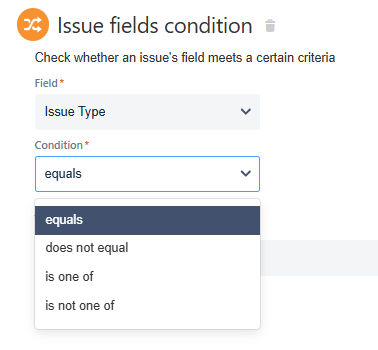

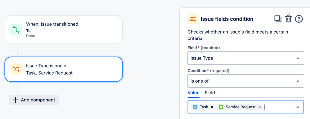

Mikael Sandberg
April 1, 2025
You are on the right track. In the IF/ELSE, pick the Issue field condition, select the Issue type field, leave the condition as equals and then in the value dropdown pick the work item type.
It should looks something like this:
You could also pick "is one of" in the condition, that will turn the value dropdown into a multi-select so you can pick all the work item type the automation should trigger on instead of using the "At least one condition matches" option.
Like • Vijay Kumar likes this

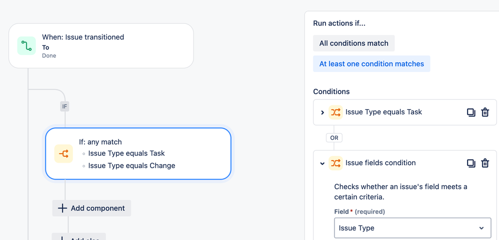

Mikael Sandberg
April 1, 2025
The alternative would look like this if you do not want to use the IF/ELSE:
