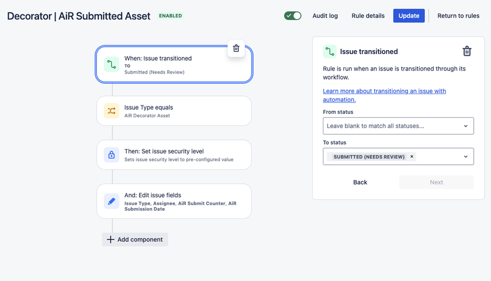

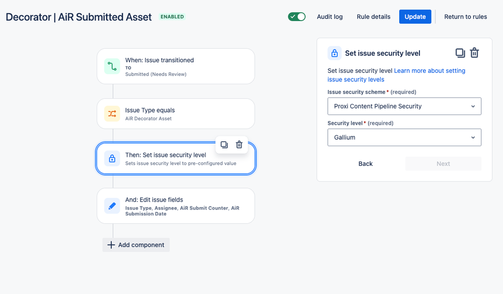

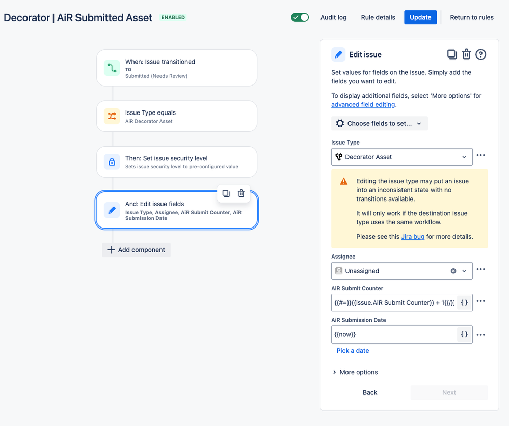

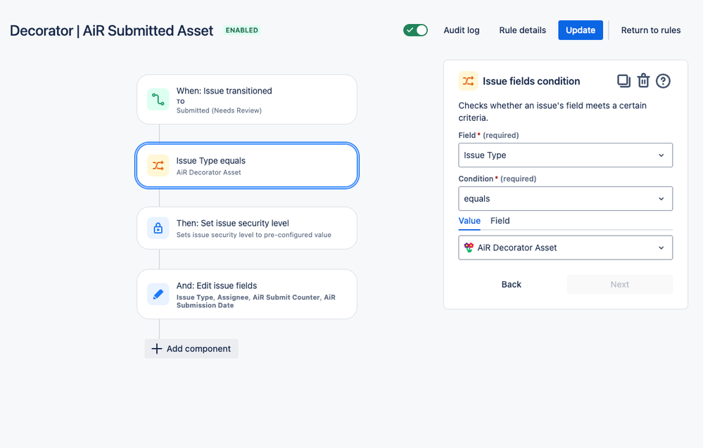

I have automations that take the issue from the locked down type -> the internal type when certain criteria is met. When those automations happen, the tickets are flow to transition and a user who shouldn't be able to see the internal ticket and its additional fields is seeing them until they refresh. To solve for that I tried to add a "Set Security Level" step to the automation BEFORE the issue type changed to the internal type.
My expectation was that the issue would no longer be visible by the user and THEN the automation would change the type and our internal people could see the ticket with all the added fields.

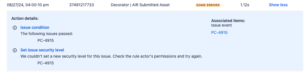

What I experienced was that the automation failed at the Set Security Level citing "Actor does not have permission..." and then the automation would fail before the next step of changing the issue type to the internal type.
The addons is part of both security levels.
The addons is added to all permissions in the permission scheme.

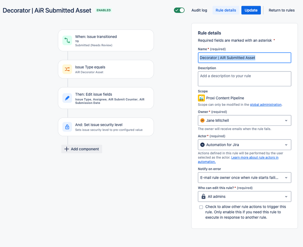

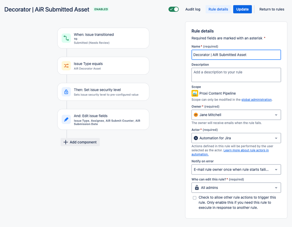

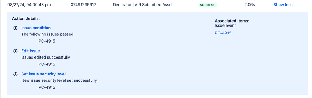

Here is the flow that is failing:
Screenshot 2024-08-27 at 5.34.38 PM.pngScreenshot 2024-08-27 at 5.34.44 PM.pngScreenshot 2024-08-27 at 5.34.51 PM.png
If I change the order of the automation to set security once the Issue Type is the internal type with all the permissions, then it works fine.

When asking for help with an Automation Rule it will enable us to help you if you share screen images of your entire rule, details of each step, and the details of output in the rule execution Audit Log.
Who is the Actor for the rule?

Got it - original ticket updated to include screenshots.
The actor is Automation for Jira.

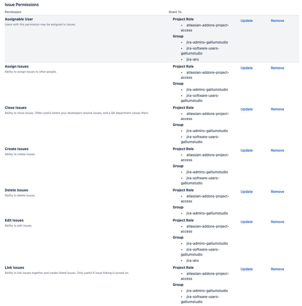

Can you share with us the Permissions you have granted to the add-ons role in the Permission Scheme used by the project?

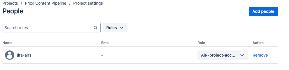

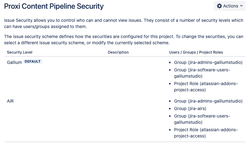

Security Level "AiR-project-access" is set to only expose a single project within Jira for the external users. Members that are external are assigned to that level while internal users are assigned the default level. That issue security scheme is applied to the project.

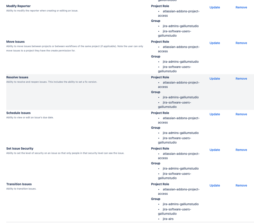

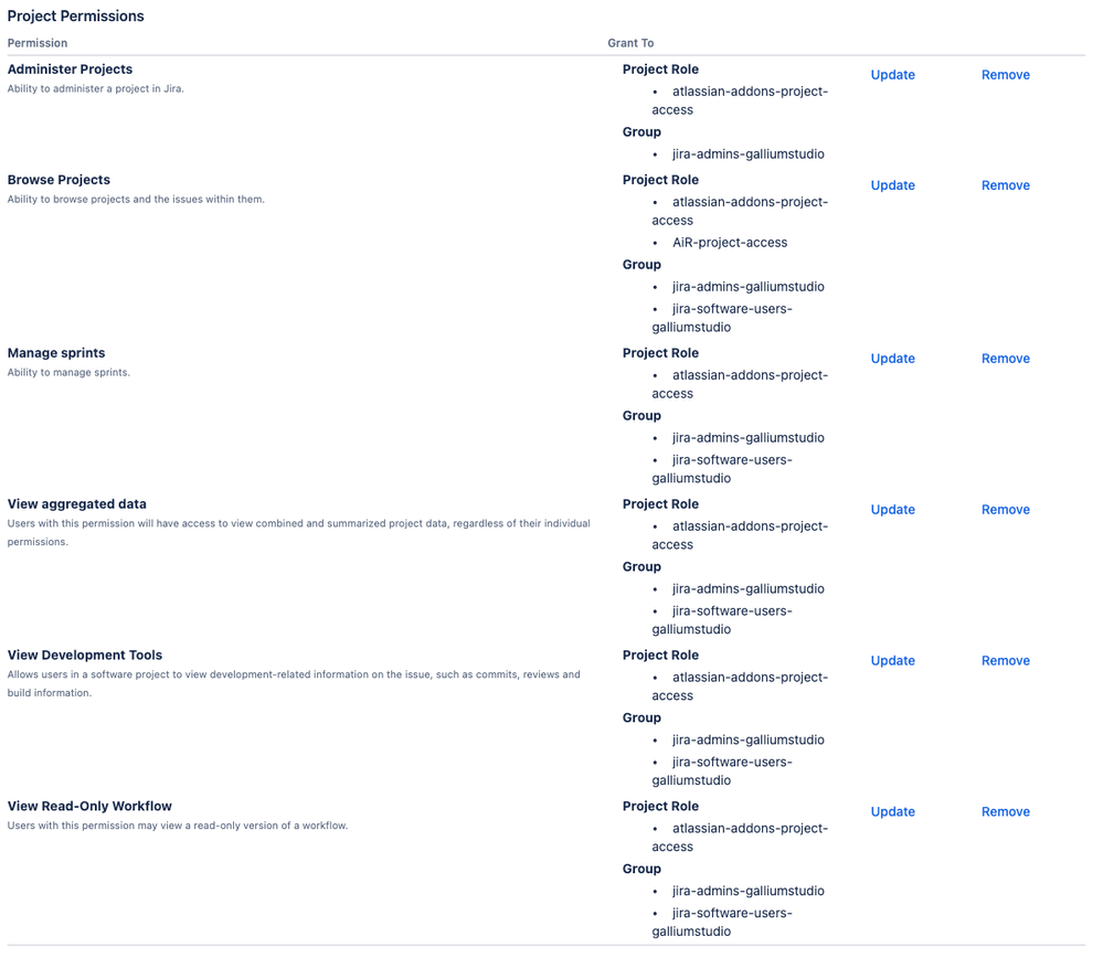

Adds on role has access to every permission so the automations can run any of the steps in the project.
Screenshot 2024-08-28 at 1.08.01 PM.pngScreenshot 2024-08-28 at 1.08.19 PM.pngScreenshot 2024-08-28 at 1.08.09 PM.png
In the above paragraph, and using the images as reference, I'm a little confused by your terminology. The Security Levels are named Gallium and AiR.
The term "AiR-project-access" shows up in the Roles field on the People page for the project, so that seems to be the name of a Project Role rather than a Security Level.
It looks like you have two user groups: jira-air and jira-software-users-gallium. Do you assign your external users to be members of only the jira-air group, while your internal users are members of jira-software-users-gallium?
