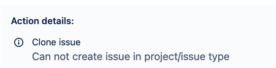

What I want to do is for each new ticket created, clone it to the internal board. I created the automation but can't seem to make it work. The log says "Action detail - Clone issue: Can not create issue in project/issue type". Been searching and tinkering with permissions but can't make it work.

- The automation worked perfectly running in the same project (company-managed), being a ticket created and cloned in the same project. When I want to create a ticket in the next-gen project board to clone it to the other project board this is what the log error shows:
That's why I think is something related to permissions. In the permission schemes, "atlassian-addons-project-access" has access everywhere. So I'm wondering what could be going on.

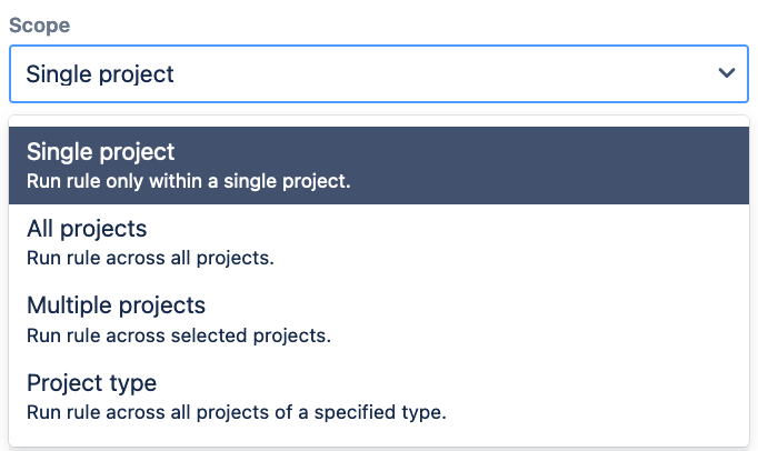

I also thought it could be the scope but tested it in multiple ways and nothing.Screen Shot 2022-02-01 at 9.56.13 PM.png

Hi @Alvaro
Cloning into Team Managed project is not possible as of now
Please feel free to vote on a feature request here
https://jira.atlassian.com/browse/JSWCLOUD-18079
You can clone the issue to company managed project
