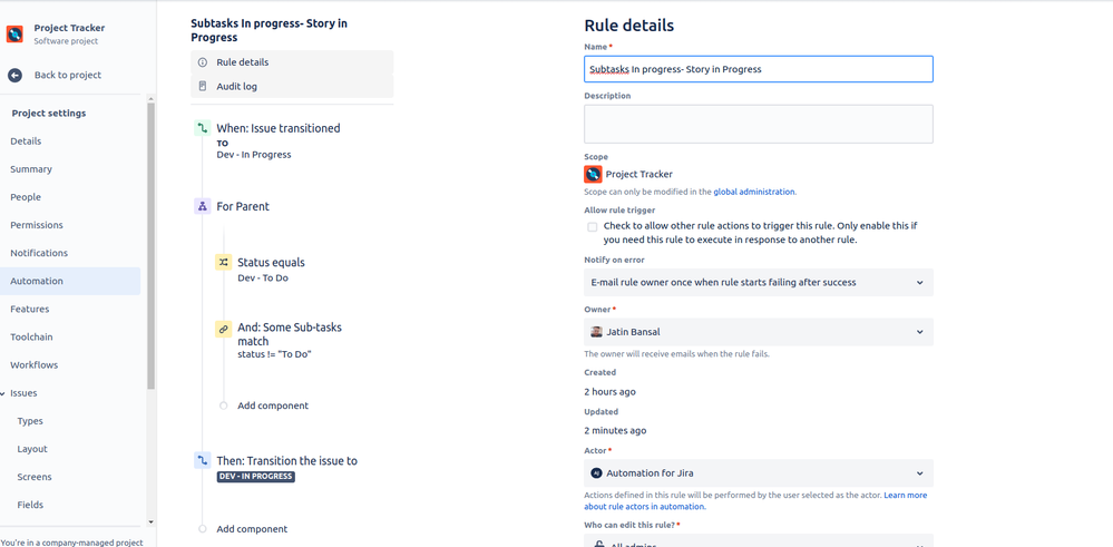

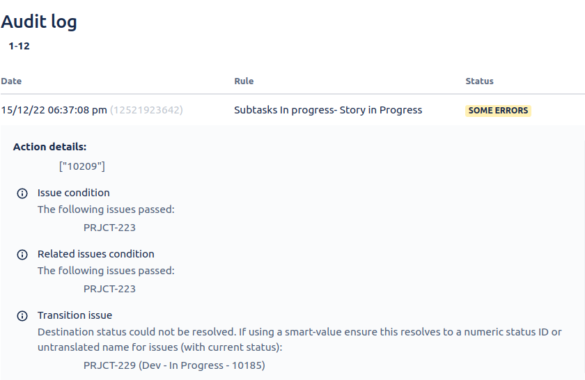

I want an automation rule in which if any task is in progress, the story should automatically moved to In progress
And the start date should be set to Current date
How Can I set that?
I have done so far, just stuck in the smart value for current date
I have configured this to {{now}}
But this is not working
Attached are the screenshots
It is failing at each attempt.Screenshot from 2022-12-15 18-18-18.pngScreenshot from 2022-12-15 18-18-50.png

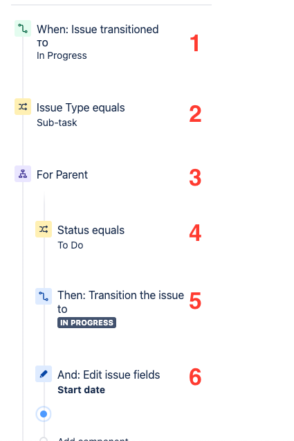

My apologies. You are correct that you cannot choose the Status field in the Edit action. To change the Status of an issue in Automation you need to add a Transition Issue action.
I believe this is the rule you want.Screen Shot 2022-12-16 at 8.23.02 AM.png
1. When an issue transitions to In Progress.
2. And that issue is a Sub-task
(We don't want to execute this rule if it was some other type of issue that transitioned to In Progress)
3. Then find the Parent issue for the Sub-task
4. And if the Parent issue status is To Do
(Here you would check if the Parent issue status was any of the statuses that come before "In Progress" in the workflow. If it is "In Progress" or farther along in the workflow, then we don't want to move the Parent issue backwards to an earlier Status.)
5. Then transition the Parent issue to In Progress
6. And set the Start Date for the Parent issue.
(I'm assuming you wanted to set the Start Date on the Parent issue. If you want to set the Start Date on the Sub-task that triggered the rule, then you need this step to be outside of the For Parent branch.)

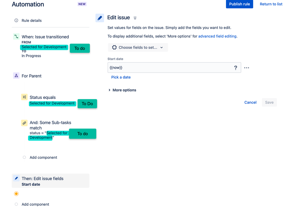

Marta Woźniak-Semeniuk
December 15, 2022

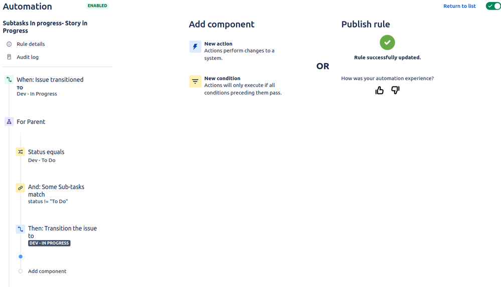

Hey @Jatin Bansal I think you wrote the automation in way where the action is in the branch checking conditions instead of the main branch :) Just remove the "Then action from the sub-branch and add it ot the main branch and it will work.
If you need help with that - let me know :)
Jatin Bansal
December 15, 2022

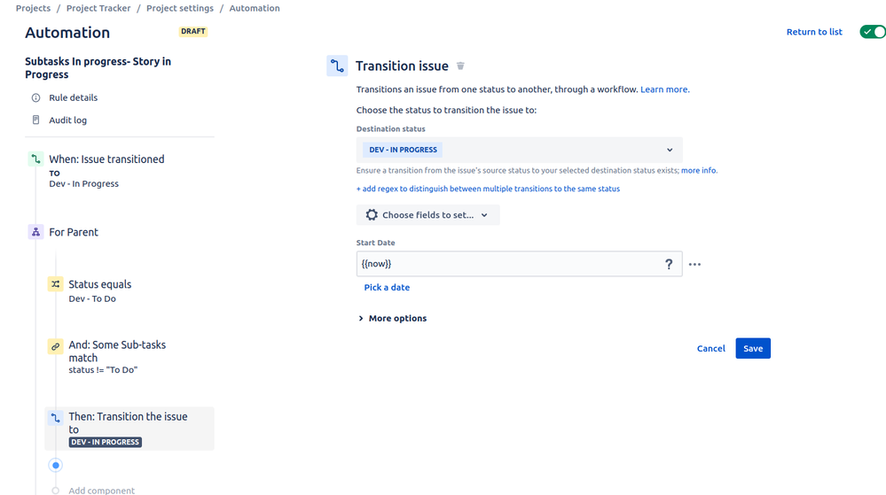

Thanks for the suggestion
Changed that to the below
Still facing issues
Screenshot from 2022-12-15 18-39-30.pngScreenshot from 2022-12-15 18-38-48.png
December 15, 2022
You have the final action the same as the trigger. You last action should be "Edit Issue fields" and it should change start date to {{now}} using smart values

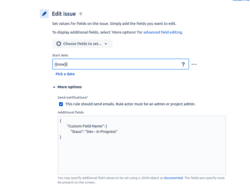

I have to do both Status as Dev-In Progress and Start Date as Now
But Status is not available in fields, so I used advanced
But, this is also showing error as not valid Json
Can you help rectify this
Trudy P Claspill
December 15, 2022
When you need to set multiple fields, simply click in the "Choose fields to set" to select each additional field and set a value for it.

Yes, I choose that only
But the status was not the part of those fields.
December 16, 2022
Your automation should look like this, only with TO DO where I have "Selected for development"
