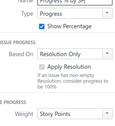

Have a Progress column in structure : Progress based on Resolution Only with Story Points with aggregates  sum of story points. Selected Progress based on story points on gantt chart- but they dont reflect the same. Is there a way to add formula to reflect same progress percentage at structure.gantt level as well?jira.strcuture-q1.JPG
Would like high level story point progress - on structure.gantt to also reflect based on this .

In the "Based On" dropdown there is Progress among "Standard attributes" - this is the Structure's progress - this will make Gantt progress identical to Structure's.

I dont want to change the structure's progress. I would like structure to reflect based on current setting and not on time tracking. Is there a way to reflect the progress based on my current setting on structure show on gantt chart.
For eg: If i have a structure which has an epic required my multiple sub epics pulled in structure the progress is reflected correctly on Strcuture view but not on gantt chart view.

Sorry it seems I did not formulate clear enough - my suggestion does not require changing structure's progress, you can simply use it in Gantt. Open "Based on" dropdown and select Progress.
