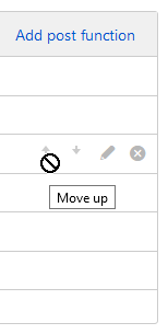

Hello, thanks for the hints, I have tried that, but changing the order of post-functions is not possible:

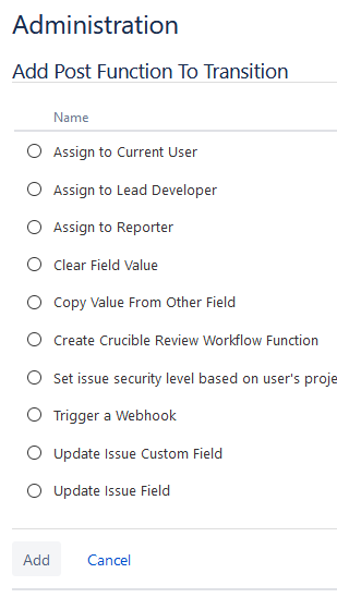

Unfortunately, there are no post-function to set-up the property:

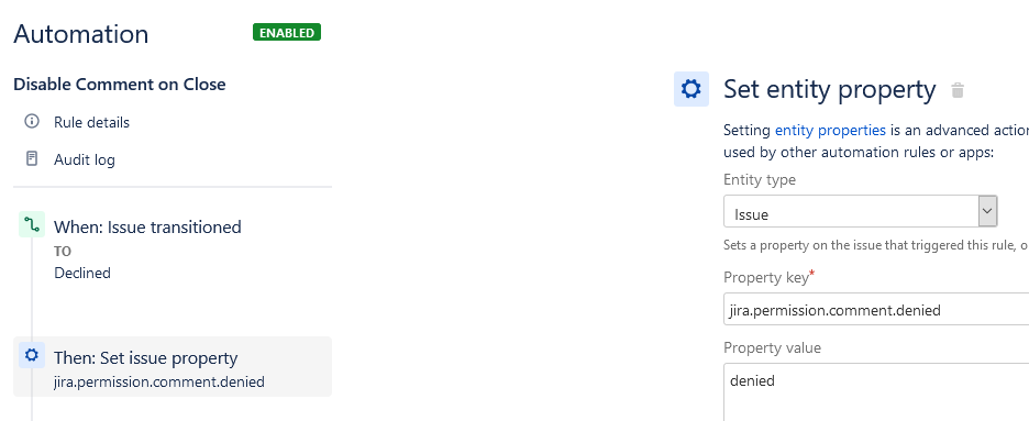

So I have tried also the automation. Automation was fired correctly, but the property did not work.....
2020-09-24 08_52_47-Automation rules - Jira.pngAny clue? :)
