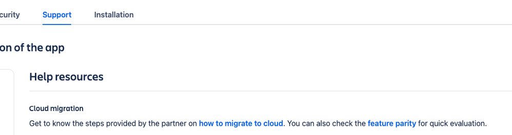

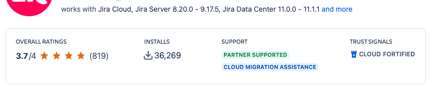

Next, for each plugin that you have find the listing for that plugin in the Atlassian Marketplace. Determine if it has a Cloud version. Check the Support section in the header to see if it says "Cloud Migration Assistance". Check the Support tab to see if they provide information about how to migrate to the Cloud and Feature Parity information.
Screenshot 2025-11-28 at 7.52.15 AM.pngScreenshot 2025-11-28 at 7.52.30 AM.png
