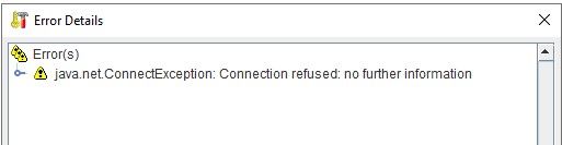

Not sure if this helps, but I have tried using the Examine SSL option in Porticle, and I get the following error for our Host IP
