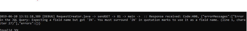

I am using Export function of QMetry for Jira for get Test Case information. I export data by command line. I want to filter the test case result only contain TestCase. I try use JQL clause but the error is appear. I not sure about syntax correct. Could you help me about syntax?

I run the command line as below, please take a look:
java -cp ImportExport-1.7.5.jar com.infostretch.importExportUtility.cliController.Main user@example.com   --my email
<removed> -- my token
<removed> --my api key
https://example.atlassian.net --my host
C:\Export\QTM_2019-06-20_Export.xlsx --my path
issuetype IN ("TestCase") -- my JQL
PHW --my project key
Best.
Hao.
Reshma Padkil
June 20, 2019
@Hao Bui ,
Yes, the JQL is wrong. It should be - issuetype in ("Test Case").
"Test Case" issue type has space.
