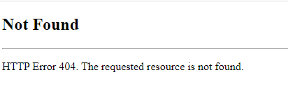

Hello Guys,
We are using Jira 7.1.9 and it is working fine with a nginx reserve proxy. Now we are switching to HAProxy. Every server and product in datacenter working fine except Jira. Does anyone have an idea or experience about it?
Both http://jira.xxxxx.xxx and https://jira.xxxxx.xxx are giving the following screen

Your config doesn't look wrong at all.
We also run our Jiras behind HAProxy, the main difference is that we use the HTTPS scheme with proxyPort=443 set in server.xml rather than plain HTTP with proxyPort=80.
Also your screenshot doesn't look like Jira DC 404s at all. Are you sure that the HAProxy hits the correct backend?
