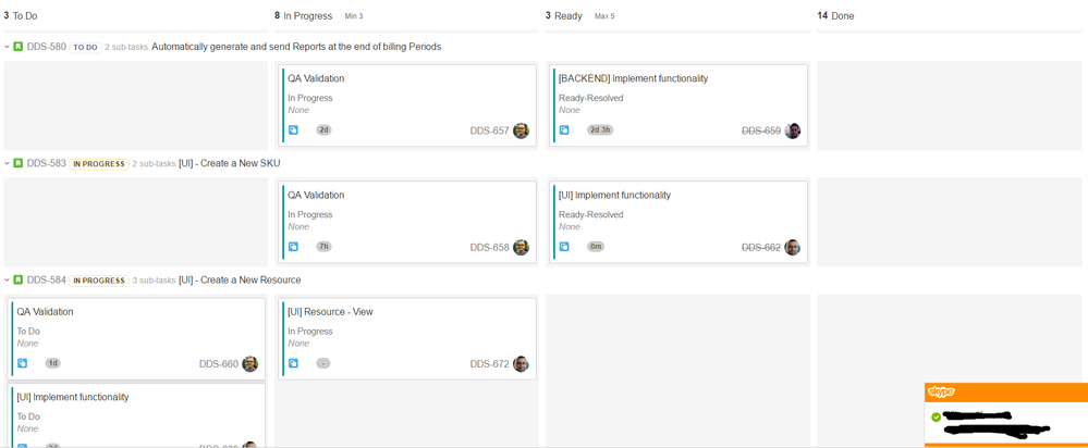

One of our users raised an interesting query about a Sprint board, more precisely if there's any way that in the board's settings > Swimlanes, without changin the setting from Queries, can we group the Stories with their associated sub-tasks.
For example, if on the Swimlanes, we leave the "Base Swimlanes on" option to "Stories", the board will show Stories, with their associated sub-tasks. However, we would like that the option be set to Queries, but also show the Stories and their sub-tasks.
So, this:

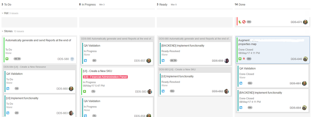

JiraQueries_Swimlanes.png..would need to be turned into this:
JiraSwimlanes_Default.png..without changing the "Base Swimlanes on" from Queries.

I hope I'm not disturbing etiquette with a graveyard post. How was the first image @Razvan Radulescu posted achieved?
That's exactly the configuration I'm trying to set up (sub-tasks within the same swimlane as parent issue types) but no luck so far.

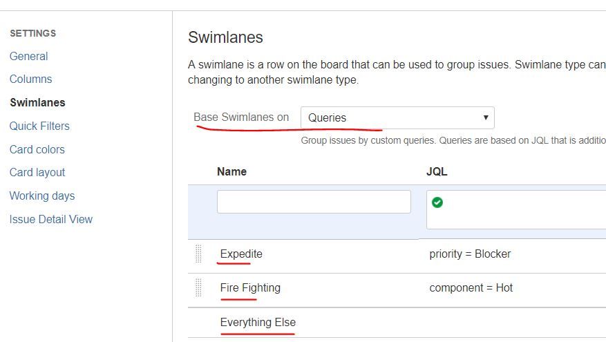

@David Marshall No plugins needed here. You have to go in the board's settings and do something like this:
