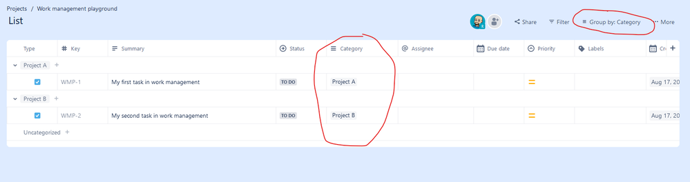

Hi @Stefan Froehlich
Maybe you can use the Category to identify projects?
This allows you to group and filter on them.

You can look at the documentation on organizing your lists. On this page, you'll see that category is one of the options to sort / group your issues by in your list.
If you need additional attributes to filter your issues on, you can use Components and Labels. Or even completely new custom fields.
But the List view grouping only allows grouping on Assignee, status, priority and category. But Filtering can be done on pretty much anything. Both in the List and Board.
