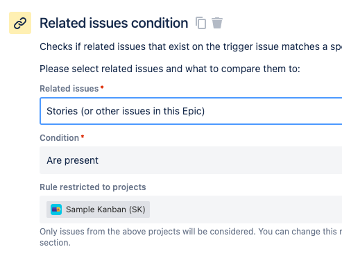

Also note that if this is for a Team Managed project, in the JQL of the Lookup Issues action you need to use Parent rather than Epic Link.
I would also recommend adding a condition after the check that the trigger issue was an Epic to ensure that the Epic has child issues.

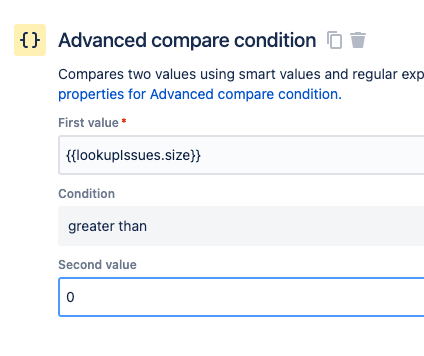

Or add a condition after the Lookup to ensure that the Lookup found issues:
