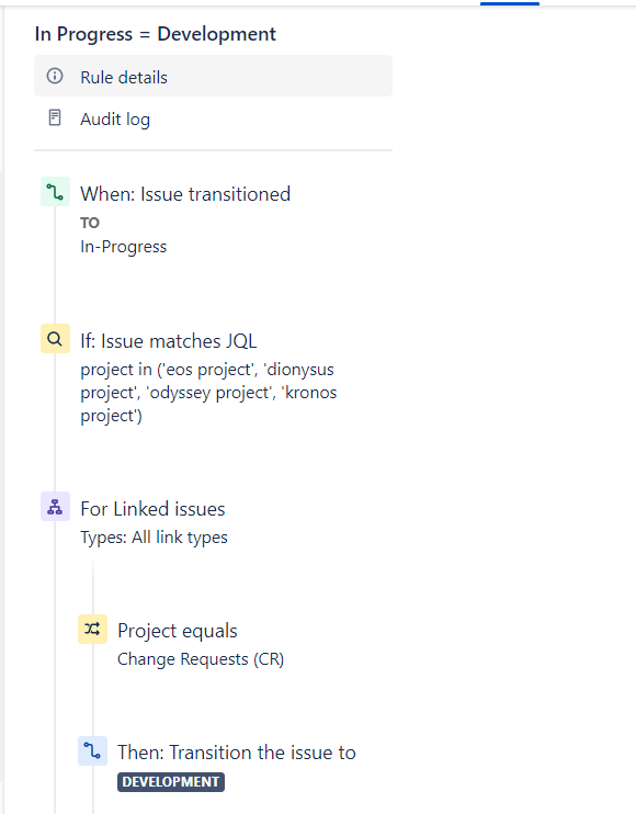

Hi there
Why would a global rule work in 1 project and not the other?
The rule does the following:
When the status changes to 'in progress' in one of the projects, the status in the service management project/workflow must change to 'development'. The rule works for 1 project but not the others. Here is the rule

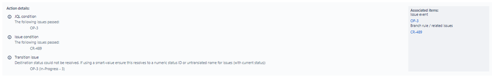

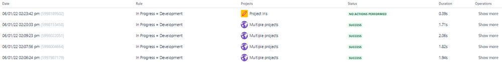

Thembisa Ndlamlenze
January 6, 2022
Hi @Bill Sheboy  @John Funk  @Fabian Lim
Below is the error I was getting. I haven't touched the rule since I left (I checked config changes in case anyone else did) but I just tested now and it suddenly works, not sure what happened. Do you have any idea?
Thanks all for your help by the way
Bill Sheboy
January 6, 2022
Thanks, @Thembisa Ndlamlenze
One cause of that error is when the transitioning issue does not have the selected status in its workflow.  For example, when the source issue (of the status) is a different issue type than the destination one.  Have you checked if there have been changes to workflow for the destination issue's Issue Type?
The other cause I have seen for this error is when there are multiple statuses defined with a Status Name (and so they have different Status ID values).  The transition is trying to use one that is not supported by the destination issue type's workflow.

Thembisa Ndlamlenze
December 9, 2021
Thanks Fabian
Error
Destination status could not be resolved. If using a smart-value ensure this resolves to a numeric status ID or untranslated name for issues (with current status):
